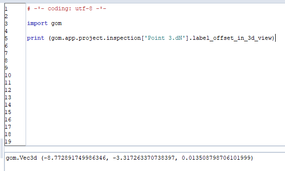

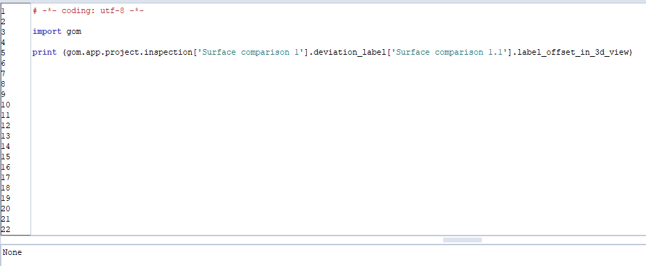

[Ma...] Posted November 26, 2025 Share Posted November 26, 2025 Good morning to all, I have to get the position in the active 3d view of a label. With a dn label this is possible, but with a normal label it seems that it's not possible (the result is None). I am wrong with something? Link to comment Share on other sites More sharing options...
[Ma...] Posted November 26, 2025 Author Share Posted November 26, 2025 If found the bug: if you just visualize the label, the offset posizion in 3d view is None, if you move the label the property "label_offset_in_3d_view" start to work. I attach a video about this that I think i't a bug. GOMSoftware_pHeRErwJac.mp4 Link to comment Share on other sites More sharing options...

[Na...] Posted December 10, 2025 Share Posted December 10, 2025 Hi Marco, I think this is a feature. The offset only exists, if the label was moved from its original 'standard' position. Link to comment Share on other sites More sharing options...
[Ma...] Posted December 12, 2025 Author Share Posted December 12, 2025 Hi Nanno! My goal is to take the vector and the position in the 3dview of a dn label then create a normal deviation label in the same position of the dn label. Do you know the right way to do it? Link to comment Share on other sites More sharing options...

[De...] Posted December 15, 2025 Share Posted December 15, 2025 ah, label position in 3d view. thats a tough one, you could prob use that apply selection function + label offset in 3d view to get the gom.Vec3d, but i'm not sure theres a function to then set that attribute. I tried for label in gom.ElementSelection ({'category': ['key', 'elements', 'part', gom_part, 'explorer_category', 'inspection', 'object_family', 'deviation_label', 'type', 'deviation_label_surface']}): gom.script.explorer.apply_selection(selection = [label]) print(label.label_offset_in_3d_view) gom.script.sys.edit_properties ( data=[label], label_show=True, label_offset_in_3d_view = gom.Vec3d (5.29687008412543, 2.842170943040401e-14, -7.7582401624698605) ) which prints all the positions, but doesnt work for setting a new position. maybe throw em all to screen edge? Link to comment Share on other sites More sharing options...
[Ma...] Posted December 16, 2025 Author Share Posted December 16, 2025 This is the code I use, but for some label it doesn't work. I don't know why. What command I can use to put them, if label offset is None, to the screen edge? def dn_in_label(): #Pulizia report pagine_da_pulire_lst=[] for pagina_da_pulire in gom.app.project.reports: pagine_da_pulire_lst.append(pagina_da_pulire) gom.script.report.update_report_page ( pages=pagine_da_pulire_lst, used_alignments='report', used_digits='report', used_legends='report', used_stages='current', used_units='report') reports = gom.app.project.reports for report in reports: print(report) pages = report.pages for page in pages: print(page) elements = page.elements for element in elements: print(element) if element.get('type') == 'figure_snapshot_frame': componente = element.parts_in_report print(componente) # stampa il valore di 'componente' part = gom.app.project.parts[componente] gom.script.report.restore_3d_view_from_report_page(page=element) visible_dn_lst = [] visible_measure_lst=[] # Filtra i punti che contengono ".dN" e sono visibili for dn in gom.app.project.inspection: print (dn) print (dn.scalar_value) if ".dN" in dn.name: if dn.is_visible: visible_dn_lst.append(dn) if dn.scalar_value is not None and dn.scalar_value > 0: if dn.is_visible: visible_measure_lst.append(dn) print (visible_measure_lst) gom.script.cad.hide_element (elements=visible_measure_lst) # Per ogni punto dN visibile for dn in visible_dn_lst: coordinata_dn = dn.center_coordinate normale_dn = dn.normal dn_pos = dn.label_offset_in_3d_view # Per ogni confronto superficie visibile for confronto in gom.app.project.inspection: print (confronto) if confronto.get('type') == 'surface_comparison' and confronto.is_visible: print(confronto) # Chiamata allo script per ogni coppia punto/confronto MCAD_ELEMENT = gom.script.inspection.inspect_by_deviation_label(point={'interpolated': True, 'normal': normale_dn, 'point': coordinata_dn, 'target': confronto}) gom.script.cad.hide_element (elements=[dn]) label=MCAD_ELEMENT print (label) gom.script.sys.edit_properties ( data=gom.ElementSelection (label, {'attachment_group': [None, 'criterias']}), elem_show=True, label_show=True, label_template='Annotazione di Deviazione', label_template_uuid='3807e37f-a68f-4bed-b65c-61f0ddd1000c') gom.script.cad.set_label_position(elements=[label],offset=dn_pos) gom.script.sys.switch_to_report_workspace() gom.script.report.overwrite_report_page(target=element) Link to comment Share on other sites More sharing options...
[De...] Posted December 16, 2025 Share Posted December 16, 2025 hmm, didnt know that was a function, (would be nice if we had a global list of these things somewhere) for labels on screen edge: gom.script.cad.set_label_distribution_mode (distribution_mode='border') try and drop the s) from elements, and dont use a list. docstring is kinda confusing, try and just use the arguments (element & offset) print(gom.script.cad.set_label_position.__doc__) cad.set_label_position (Move Label) - Move Label Parameters: Name | Description | Type | Optional -------------------------------------------------------------------------------------------------------------------------- element | defines the name of the element | Tom::Reference | No elements | defines the names of the elements | Tom::MCADCmd::Traits::ElementSelection | No position | defines the position of the label | Core::Types::BaVec<2,double> | No offset | defines the 3d offset of the label | Core::Types::BaVec<3,double> | No offsets | defines the 3d offset of the label | QVariantList | No view_index | defines the index of the view, where the label gets moved | uint | Yes position seems to be is in lieu of offset (?)- or atleast thats what the error said when I tried to use it. gom_part = gom.app.project.parts[0] for label in gom.ElementSelection ({'category': ['key', 'elements', 'part', gom_part, 'explorer_category', 'inspection', 'object_family', 'deviation_label', 'type', 'deviation_label_surface']}): gom.script.explorer.apply_selection(selection = [label]) print(label.label_offset_in_3d_view) gom.script.cad.set_label_position( element=label, # position = gom.Vec2d(15,25), offset=gom.Vec3d (20,-20,-20) ) ^^seems to work like the 'justify label' button anyways, good luck! Link to comment Share on other sites More sharing options...
