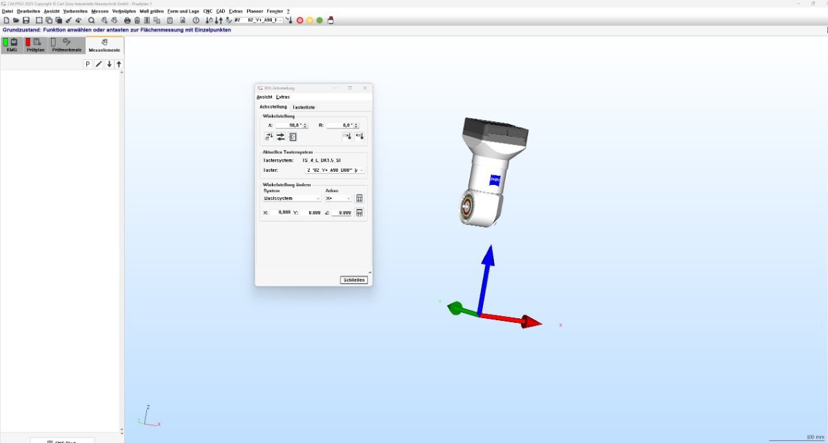

Hello everyone,
I've noticed that since Calypso 2025, there's no longer a button for changing the RDS axis position. However, I've discovered that I can import SSC data via the Planner tab, even though I don't have a Planner seat. I tried it out and built a Stylus.
This image shows the axle position without SSC.

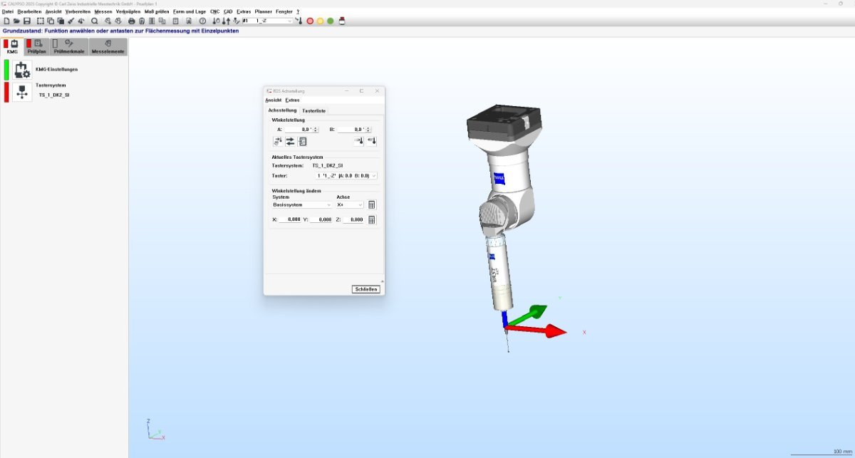

And this one with SSC
Is it possible to import SSC data into existing styluses?
Or do I have to rebuild all the buttons with the SSC?
