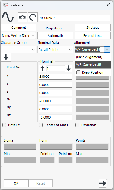

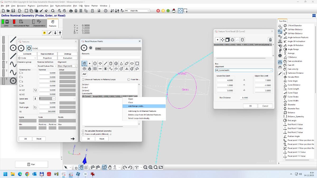

[Ma...] Posted December 1, 2025 Share Posted December 1, 2025 If you make curve with many measured points, then what i would do: make copy of measured curve and recall all points mask radius points + a few more in copied curve use alignment from many curves with translation in Z and X, no rotation ( or if it's not perpendicular, then rotation in Y ) with copied curve copy measured curve again with recalled points and use feature alignment from previous step extract nominal circle and do recall points from curve with selection box. You can select features alignment so now you will have this box always set according to alignment from curve Need pictures? I am not sure if i will have a time for that today 1 Link to comment Share on other sites More sharing options...

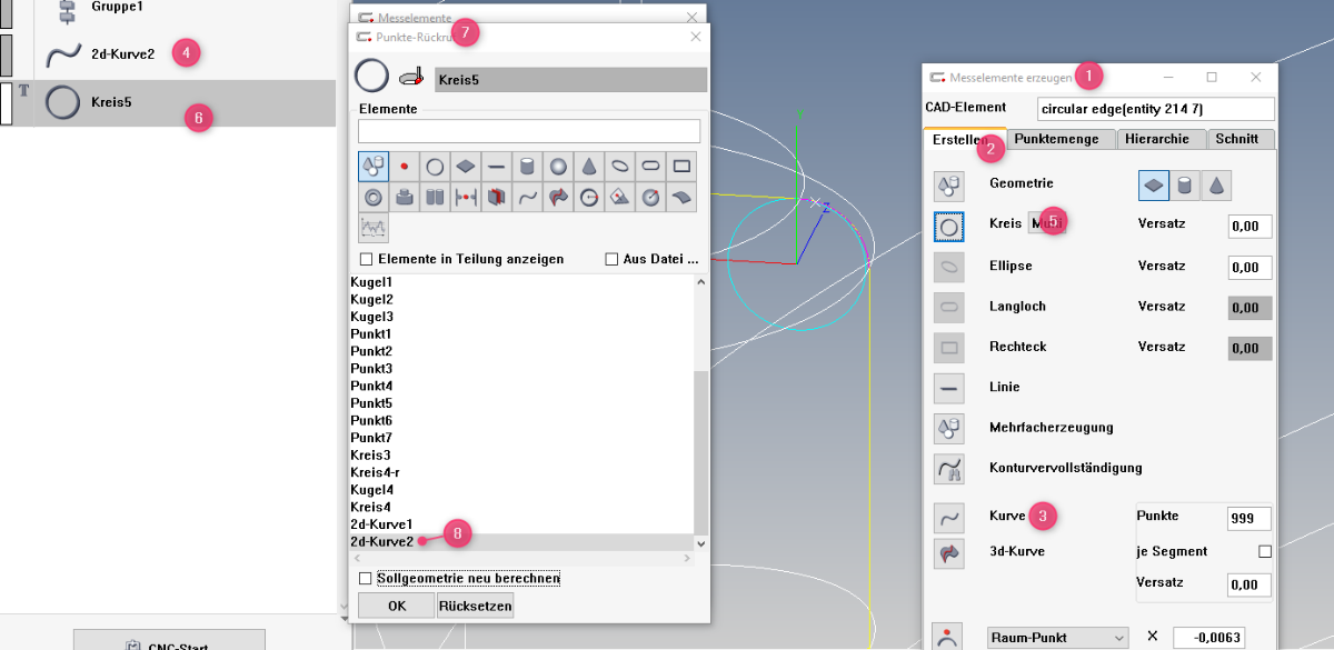

[Ch...] Posted December 3, 2025 Share Posted December 3, 2025 Halo Andreas, bist du noch dran oder hat es geklappt? 1. einen Schnitt erstellen das Du die Kurve( m. vielen Punkten 🙄) definierst und dann denselben Schnitt den Kreis auswählen, da dann Punkte Rückruf. Link to comment Share on other sites More sharing options...

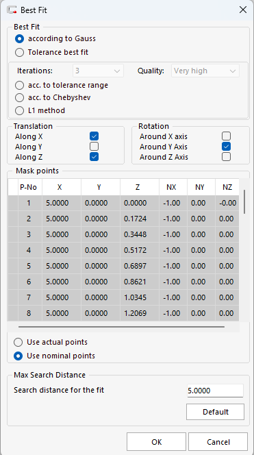

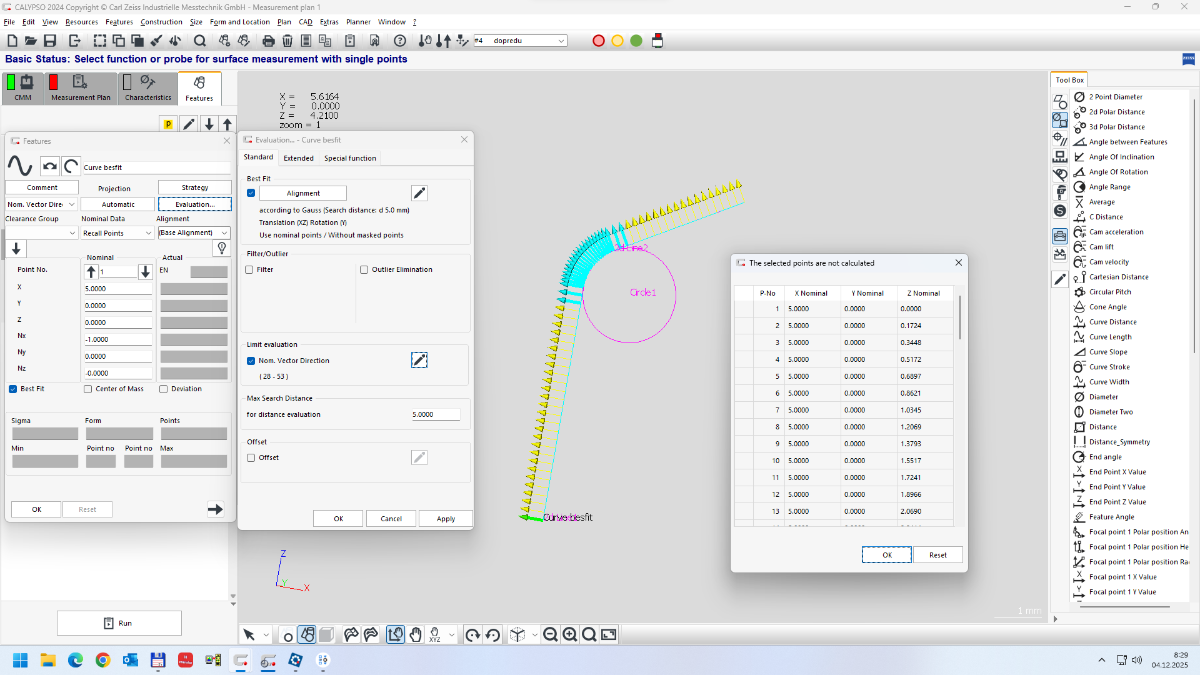

[Ma...] Posted December 4, 2025 Share Posted December 4, 2025 Please sign in to view this username. Hi, here are some screenshots: Create bestfitting curve of measured data and mask radius area Set bestfit parameters and click "Alignment" button to create selectable alignment: Make copy of measured curve and recall all measured points from it and set it up like this: Make a circle and recall measured point from this 2nd curve like this: 1 Link to comment Share on other sites More sharing options...
[An...] Posted December 4, 2025 Author Share Posted December 4, 2025 Please sign in to view this quote. sollte die Kopie der zweiten Kurve mit oder ohne Bezüge kopiert werden? Link to comment Share on other sites More sharing options...
[Ma...] Posted December 4, 2025 Share Posted December 4, 2025 Please sign in to view this quote. I am not sure what you mean. Just copy your measured curve to keep nominals, no masked points in it - recall measured points and set feature's alignment as from curve bestfit. Selection box: choose number as nominal values from drawing - bestfit will move selection box to correct spot so you will have selected always the closest point to radius. Link to comment Share on other sites More sharing options...
[An...] Posted December 5, 2025 Author Share Posted December 5, 2025 Please sign in to view this username. danke für deine Hilfe, die ich sehr schätze. Endlich funktioniert es. 1 Link to comment Share on other sites More sharing options...
