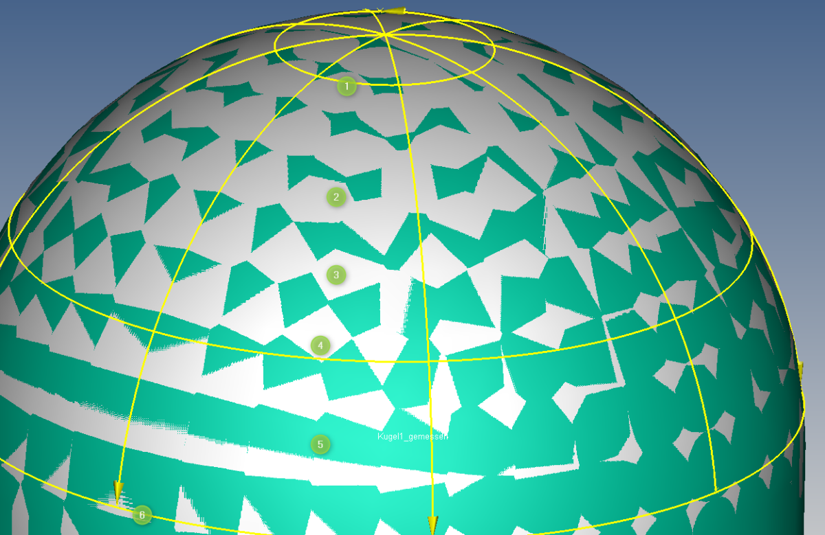

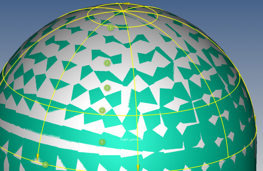

[Al...] Posted December 2, 2025 Share Posted December 2, 2025 I am trying to measure the ball radius on this part, (5) Should I measure top to bottom or measure the sphere itself? Link to comment Share on other sites More sharing options...

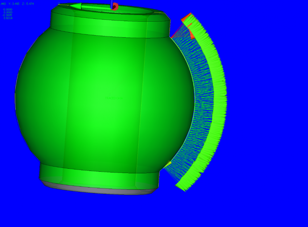

[Cl...] Posted December 3, 2025 Share Posted December 3, 2025 I would do what you are doing here all the way around the part. Maybe 6/8 times (measuring the sphere. Then create a secondary alignment (XYZ) from the measured sphere. Then measure a circle all the way around the equator referencing that secondary alignment to ensure you are at Z zero. Then use that circle in a radius characteristic. Link to comment Share on other sites More sharing options...
[Ch...] Posted December 3, 2025 Share Posted December 3, 2025 I would measure a sphere from above using 30 points or scan it. Set this as zero, datum XYZ. Then measure again with several cross-sections. As Clark suggests, 5-8 times. From this sphere, you can then evaluate the radius and also the shape to identify errors. Link to comment Share on other sites More sharing options...
[Jo...] Posted December 4, 2025 Share Posted December 4, 2025 One more aspect: Do not spread you points (circles/scanning paths etc) regularly. Depending on the manufactoring process you could end up catching only specific parts (grooves for example). 1 Link to comment Share on other sites More sharing options...
