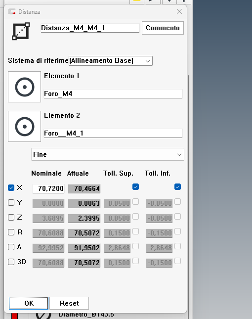

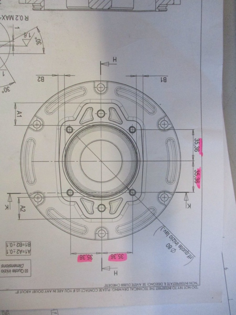

[Fe...] Posted December 10, 2025 Share Posted December 10, 2025 GOODMORNING, HOW CAN I TAKE THE DISTANCE BETWEEN THREADED HOLES? THANK YOU Link to comment Share on other sites More sharing options...

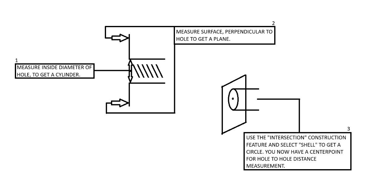

[Ma...] Posted December 10, 2025 Share Posted December 10, 2025 Measure threaded holes directly or via pins as cylinders. Then you can make intersections with plane or you can measure distance directly from cylinders. Simple distance, caliper distance and many other common methods Link to comment Share on other sites More sharing options...
[Fe...] Posted December 10, 2025 Author Share Posted December 10, 2025 i takethe threaded holes with a propeller control then i use the simple distance to measure, but a non-real measurement comes out Link to comment Share on other sites More sharing options...

[Fe...] Posted December 16, 2025 Author Share Posted December 16, 2025 Hi, I tried creating a helical path by adding a start height and a mid height, entering 1.25 in the gradient window (which is the pitch of the M8), then I checked the auto-centering option. The problem is that the probe enters the thread, tries to auto-center, but then comes out, and obviously the traffic light turns red. Link to comment Share on other sites More sharing options...
[Pa...] Posted December 17, 2025 Share Posted December 17, 2025 In strategy make sure you have your start and stop positions of your helix where you like it. Self-centering is going to require just a little more input than what you've done. In the helix strategy under special settings / self-centering is a "Parameter" box. Click it. Note that I have toggled the "angle" button until the force is specified outward (I'm using an internal thread). You can then change the axis direction. Because of the problem you encountered I would point that arrow at the hole bottom as shown here. While scanning the threads, I always monitor to ensure that the probe is advancing the correct direction for the thread, because I can get this backward during offline programming. This should help you stop falling out of the thread. Link to comment Share on other sites More sharing options...
