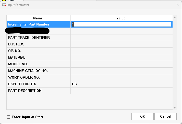

[Sh...] Posted December 10, 2025 Share Posted December 10, 2025 Does anyone know how to organize or customize the order of Report Header Parameters in the Input Parameter list shown below? Link to comment Share on other sites More sharing options...
[Ma...] Posted December 10, 2025 Share Posted December 10, 2025 As far as i know this wasn't sortable and still is not. If it's not depending on order written in that file, then you can not change order. What you can try out is using all parameters as user defined with naming like u_1export, u_2worder naming scheme. Link to comment Share on other sites More sharing options...
[Ky...] Posted December 10, 2025 Share Posted December 10, 2025 I have asked the German support team about this before and Martin is correct. It is not configurable except by changing the internal names (and even then, if you use predefined fields, that might throw you off). Link to comment Share on other sites More sharing options...
