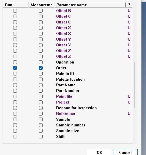

[Ri...] Posted December 15, 2025 Share Posted December 15, 2025 I am trying to get Calypso parameters for reports that gets placed in PiWeb. Such as "Order" from Calypso, which can be used in PiWeb. Right now, somehow, u_WorkOrder is "Order". But u_WorkOrder will yield " when used as shown below. I don't need the PiWeb variable. This code: OpWoID=getRecordHead("u_WorkOrderID") P.S. I am Piweb illiterate. Link to comment Share on other sites More sharing options...
[Mi...] Posted December 16, 2025 Share Posted December 16, 2025 Why is u_WorkOrder Order? Order is a predefined systemfield parameter which you can access with getRecordHead("order"). If defined, u_WorkOrder has to be a userfields parameter. Take a look in the userfieldseditor (or userfields.ini) if there's some mismatch or at the pcm code if someone accidentally set u_WorkOrder and order with the same value. 1 Link to comment Share on other sites More sharing options...
[Ri...] Posted December 16, 2025 Author Share Posted December 16, 2025 Dang, you are correct, I did not think of looking at userfields.ini. Thank you. Link to comment Share on other sites More sharing options...
