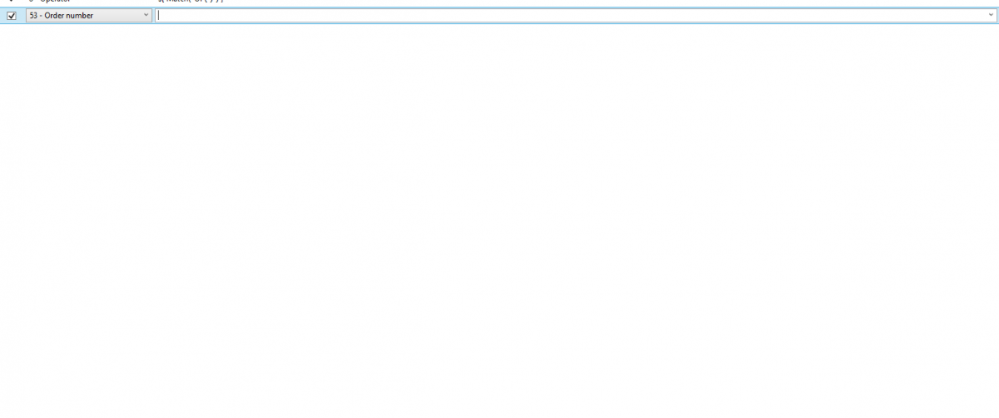

[Ho...] Posted December 15, 2025 Share Posted December 15, 2025 How can I set the import of the next row. (Messsuerements Attributes) ON = 123456 I want to load "123456" into the Order Number(K53) field. Link to comment Share on other sites More sharing options...
[Do...] Posted December 16, 2025 Share Posted December 16, 2025 Hi, try to use the expression ${ Match("ON") }. Link to comment Share on other sites More sharing options...

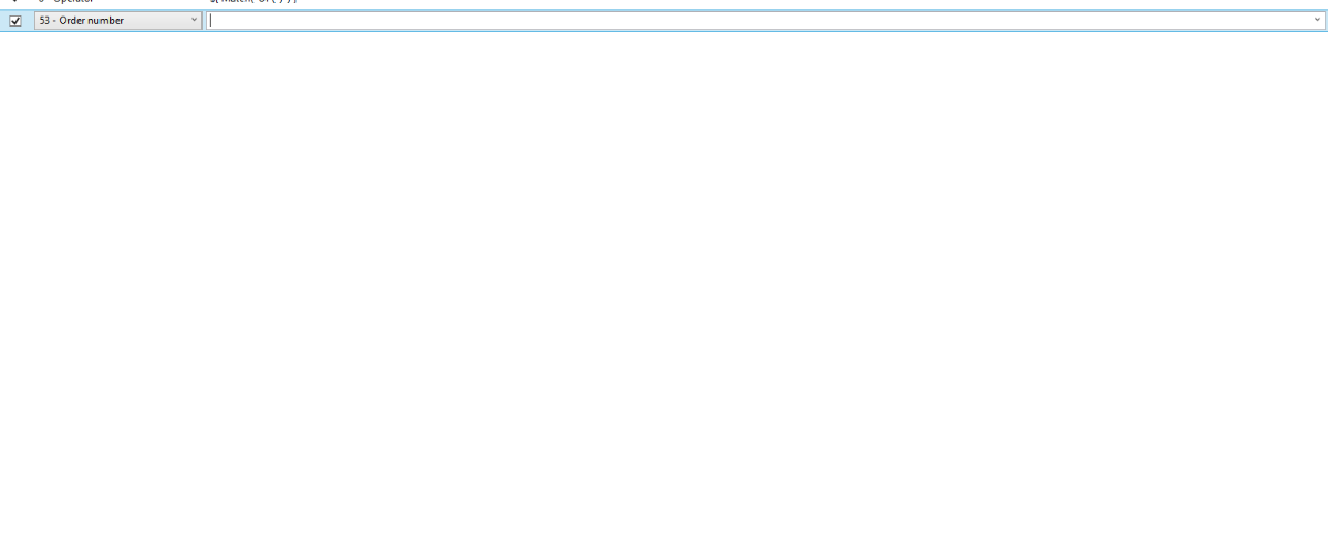

[Ho...] Posted December 16, 2025 Author Share Posted December 16, 2025 I tried this too. The value will not be green in the text. Link to comment Share on other sites More sharing options...
[Do...] Posted December 16, 2025 Share Posted December 16, 2025 Hi, that doesn't necessarily mean anything. What happens when you try to import the file? Is the attribute set? If not, I would ask you to contact your local support and open a ticket. To analyse the behaviour, we will need the version, the database configuration, the import configuration and the DMO file. Link to comment Share on other sites More sharing options...
[Ho...] Posted December 16, 2025 Author Share Posted December 16, 2025 It does not read the data. In the header settings, I set the equal sign separator 1 Link to comment Share on other sites More sharing options...
