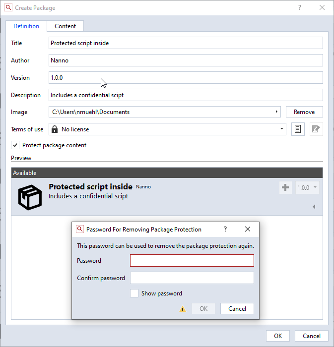

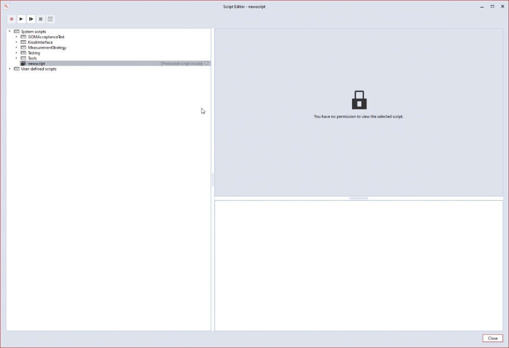

Hello Antonio,
when creating a package you have the option to protect the package content. The actual code is not visible for package users.
Regards,
Nanno
