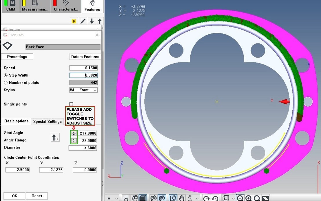

Popular Post [Ow...] Posted December 16, 2025 Popular Post Share Posted December 16, 2025 Dear Zeiss, All I want for Christmas is toggle switches in Calypso to adjust the start angle and angle range. Could be added to other strategies as well. If you think it would be a nice addition, please add it to the wish list, I’m not sure where they put that now. Merry Christmas and Happy New Year to all.🎅 8 1 Link to comment Share on other sites More sharing options...

[Pi...] Posted December 24, 2025 Share Posted December 24, 2025 I have bad news for you. This will not happen - as it would be problematic how to set default value for 1 click - you would say 1 deg but then 1 deg on big diameters would be not enough while on small 0.5 deg might be way to much. And to do relation between size of circle/step/number of points/speed would be way to complicated for implementation into software. I see your point - It could be helpful but..... Nope that wont happen. Link to comment Share on other sites More sharing options...
[Ma...] Posted December 24, 2025 Share Posted December 24, 2025 I would be more happier with mouse wheel like it's in Inspect. 2 Link to comment Share on other sites More sharing options...

[Er...] Posted January 5 Share Posted January 5 (edited) It's usually called "spinbox", toggle switches are on or off. How ever, I tried it, hated it, had to modifiy how it function, ended up sort of accepting it. https://youtu.be/k779jjXIaS8 A better christmas gift would be if some changes where made to EULA, so it implicitly allowed sharing of community adaptations. Please sign in to view this quote. Almost everytime they make adjustments to the UI, everyone screams out loudly in protest. So naturally, changes in apperance is keept to a minimum. Edited January 5 2 Link to comment Share on other sites More sharing options...

[Lu...] Posted 6 hours ago Share Posted 6 hours ago Please sign in to view this quote. you could make it to where it defaults to 1 degree, but when the button is held down it will gradually increase the ammount every couple of times the angle changes, kind of like setting an oven. so if you need to move it far you hold it down and it goes 1 degree 5 times, then 5 degrees, 10, etc until its close enough then you adjust from there. Link to comment Share on other sites More sharing options...
