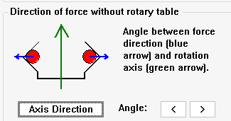

[Lu...] Posted December 16, 2025 Share Posted December 16, 2025 Hello, I have a quick question. I am trying to use self centering for a helix path on threads, but i have a difficult time understanding the graphic. Could someone explain what it is? Is it a top down view or a front view with the threads cut in half? What about that flat on the bottom what does that mean? I have tried to find information in the help menu and on this forum but i cant seem to find an explination anywhere. would this be the appropriate settings for internal left handed threads? Any help is appreciated thank you Link to comment Share on other sites More sharing options...
[Ma...] Posted December 16, 2025 Share Posted December 16, 2025 I have found no difference between green arrow up and down - i would say it's initial force push. If you are not really close to bottom of a hole, then you are good. In other words - you are good to go 1 Link to comment Share on other sites More sharing options...
[Lu...] Posted December 16, 2025 Author Share Posted December 16, 2025 Please sign in to view this quote. Thank you, what about the blue arrows? would that be different depending on if it was internal/external? Would it depend on if the threads were facing up and down or if it was horizontal? Link to comment Share on other sites More sharing options...
[Ma...] Posted December 16, 2025 Share Posted December 16, 2025 I think this is suitable even for external thread. There is option for bottom/upper, side and corner 1 Link to comment Share on other sites More sharing options...

[Pa...] Posted December 28, 2025 Share Posted December 28, 2025 Think of the graphic as a cross-section of the hole along its axis. The green arrow dictates which direction the probe will move along the axis of the feature during initial centering moves. If you're starting very near the top of the hole, you want the initial force (this green arrow) to push toward the bottom. If you have this backward (again, only if you're very near the extreme ends), the probe could fall out of the hole while seeking center. Likewise if you're close to the bottom and want to be sure you don't hit the bottom of the hole, swap the arrow. I think, though am not certain, that the green arrow pointing away from the hole bottom indicates initial centering movement along the normal vector. If, like many of us, you keep your scans away from the edges of the hole, you won't notice a difference. Link to comment Share on other sites More sharing options...
