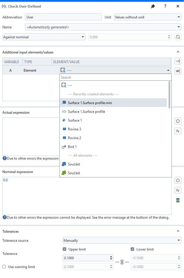

[Ri...] Posted January 9 Share Posted January 9 Before I go down a huge rabbit hole of re-working a program, is there any way to pull the nominals for a max/min deviation that I pulled from a surface profile? I am able to access the actuals, but I need the nominals as well. Any and all help is greatly appreciated. Link to comment Share on other sites More sharing options...
[Ma...] Posted January 10 Share Posted January 10 Hi Richard, I think i got into it like this: Make surface profile callout. Select this callout and extract MIN and MAX deviation flag. Select surface feature and use user-defined formula. Define Variable as picture Define Actual expresion like "A.coordinate.x" ( after first DOT it will popup ) I can not find a way to obtain nominal point. Alternative - you can create point from that surface MIN flag and report that. Link to comment Share on other sites More sharing options...

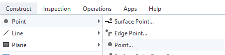

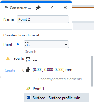

[Ri...] Posted January 11 Author Share Posted January 11 Hi Martin, Yeah - I am able to create a Point that is only the Actual, but I really need to Nominal, so that I can properly display it with the axis deviations. Link to comment Share on other sites More sharing options...
[Ma...] Posted January 11 Share Posted January 11 Using that point you obtain nominal and actual, but not in surface callout. But once you create that point, you can use nominal and actual in user defined. Link to comment Share on other sites More sharing options...
