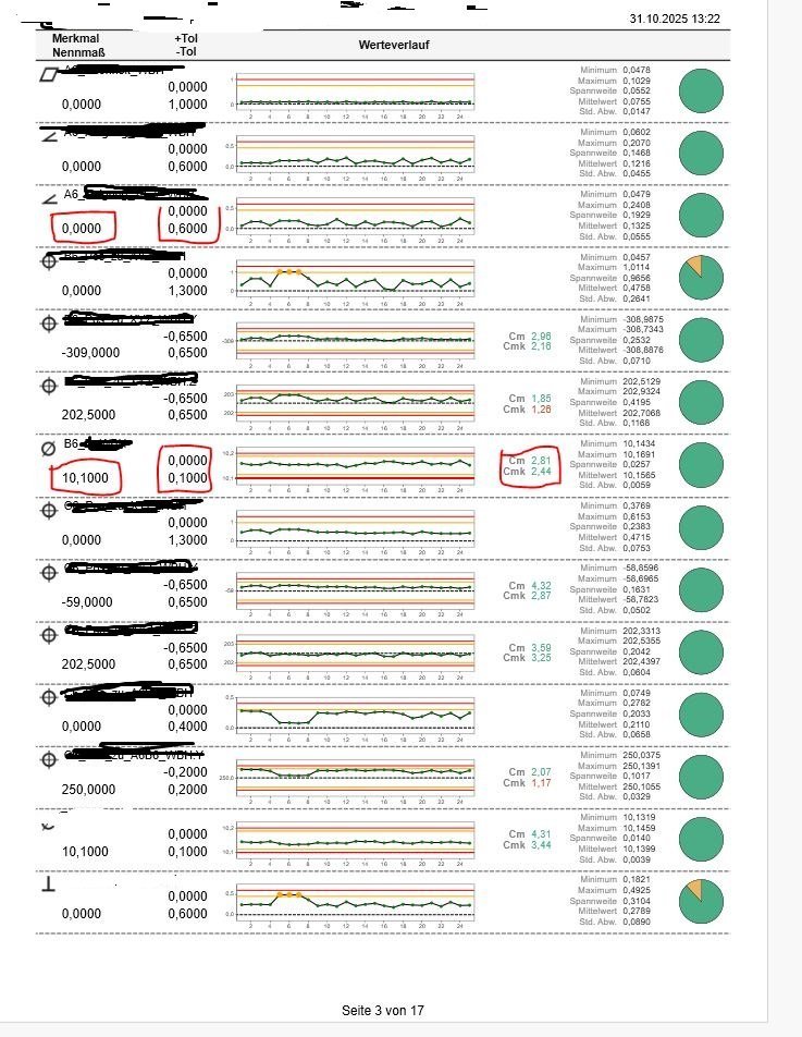

[Si...] Posted January 13 Share Posted January 13 Hey everyone, quick question: I got a code from Zeiss that’s supposed to hide Cp/Cpk results if we have a one-sided tolerance. Right now, it only works when the nominal is 0.0000. Is there a way to fix this, or is this the limit of PiWeb? The Code : ${if Equal(ToString(Qdb.Characteristic(2120)), "Natürliche Grenze") then false else true} Thanks in advance! Link to comment Share on other sites More sharing options...

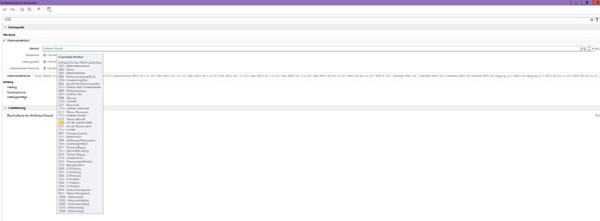

[Do...] Posted January 15 Share Posted January 15 Hi, this is expected behaviour, as you have defined a lower tolerance. If you also want to filter the characteristics with a lower tolerance of 0, you can use the following expression: ${if AnyOf(Equal(ToString(Qdb.Characteristic(2120)), "Natürliche Grenze"), Equal(Qdb.Characteristic(2112), 0)) then false else true} 1 Link to comment Share on other sites More sharing options...

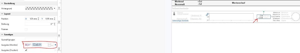

[Si...] Posted January 26 Author Share Posted January 26 Please sign in to view this quote. Hey again, after trying to export it today, the hidden values were shown, am i doing something wrong here and is there another possible fix? Thanks in Advance Link to comment Share on other sites More sharing options...

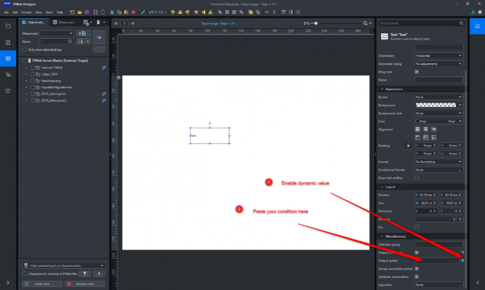

[Do...] Posted January 27 Share Posted January 27 Enable dynamic value and paste your condition into the text input field. 1 Link to comment Share on other sites More sharing options...
