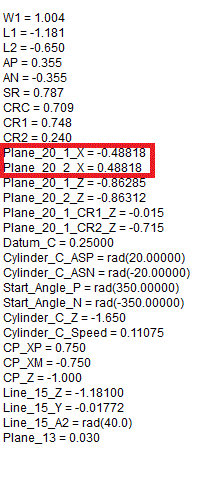

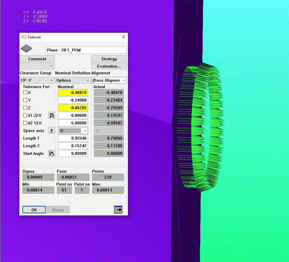

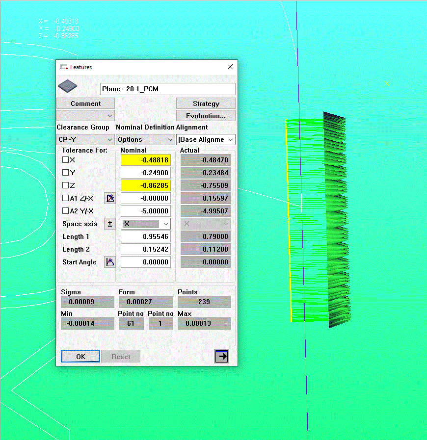

[Cl...] Posted January 15 Share Posted January 15 (edited) I have a parametric program for a family of 5 sizes. Visually the scan doesn't match where it should be on the model. I've double checked everything (I think). It's got to be something simple. Any ideas? PCM_1 shows in wireframe the scan inside the outer wall. Should be on the wall. PCM_2 is the solid view and PCM_3 is the para file showing the X variable. I must be overlooking something simple. Any ideas? BTW, I'm running this is simulation. Edited January 15 Link to comment Share on other sites More sharing options...

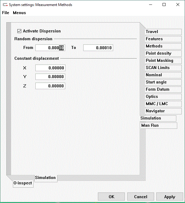

[No...] Posted January 15 Share Posted January 15 (edited) 1. Does the model displayed match the part size measured? 2. Is dispersion turned on (since nominals and actuals differ)? 3. Have you set a display scale (overheight) factor for deviations? Edited January 15 Link to comment Share on other sites More sharing options...
[Cl...] Posted January 15 Author Share Posted January 15 For questions 2 & 3 where are these settings located? Link to comment Share on other sites More sharing options...

[No...] Posted January 15 Share Posted January 15 (edited) Dispersion is under Extras/Settings/Measurement/Simulation. If it's on you should also see a yellow warning sign in the CNC start window. What I meant by 3. is magnification (I was struggling with the correct translation 😉). You can access it by right-clicking in the CAD view when a feature window is open, or in the CAD evaluation dialog. Dispersion together with high magnification can result in seemingly shifted actuals. Edited January 15 Link to comment Share on other sites More sharing options...
[Cl...] Posted January 15 Author Share Posted January 15 Magnification is set at 1 Link to comment Share on other sites More sharing options...
[No...] Posted January 16 Share Posted January 16 Then it's not that. Link to comment Share on other sites More sharing options...
[Kl...] Posted January 16 Share Posted January 16 If the screen dump shows your input, the dispersion is always in "+" direction. To create it +/- according to nominal direction, modify it to -0.0001 / 0.0001. 1 Link to comment Share on other sites More sharing options...
[No...] Posted January 16 Share Posted January 16 Oops, I missed that 😲 Link to comment Share on other sites More sharing options...
[Ri...] Posted January 16 Share Posted January 16 The times I have seen this, its usually one or the other for nominals values. If using a circle on a plane, check the Strategy for nominal values (My example works in the Z axis). If using a polyline in a plane, you also have to check nominal values. Regardless of the axis or angle of a plane, the polyline nominal for Z should be Zeros. This is why I preach about nominals and vectors being perfect. 2 Link to comment Share on other sites More sharing options...

[Je...] Posted January 17 Share Posted January 17 Besides the more likely causes that were already posted above, one oops that has caused this for me was using an improperly qualified probe (was set to reference sphere 1 when 2 was actually probed), or a different probe was attached then what was defined. Or, a bent probe shaft. 1 Link to comment Share on other sites More sharing options...
