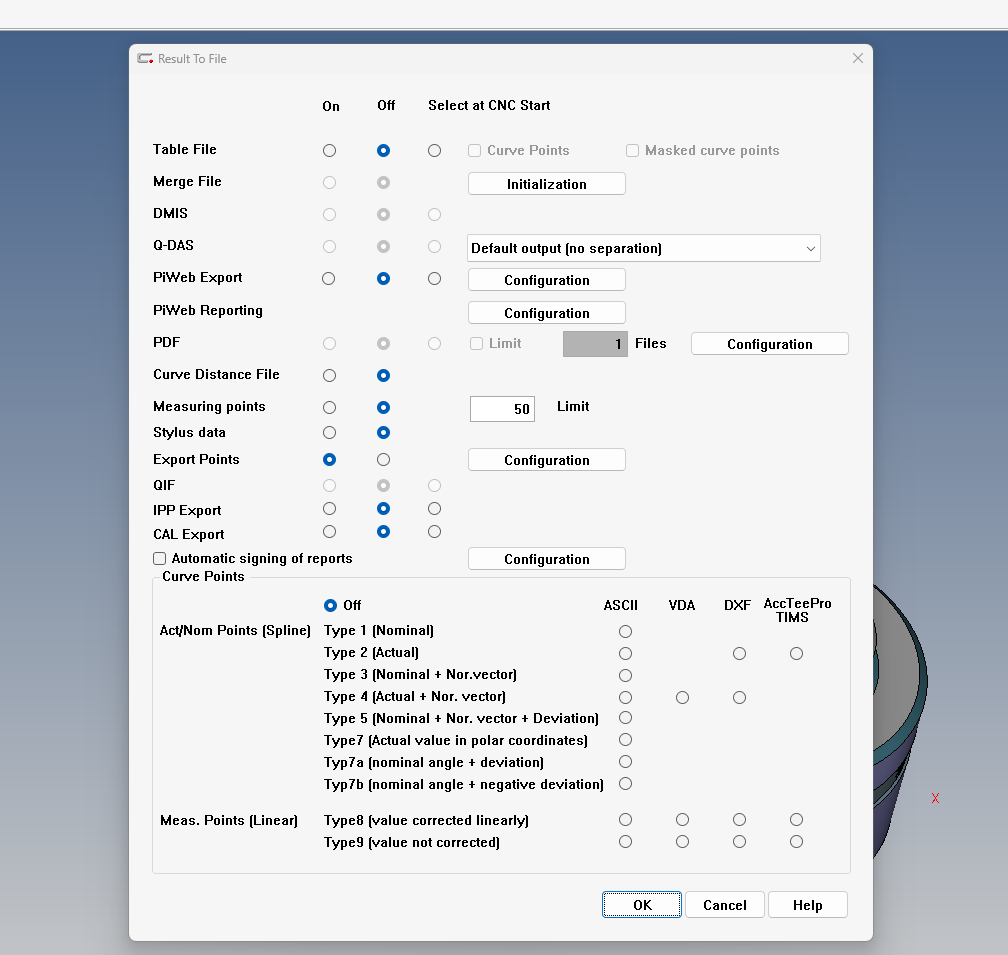

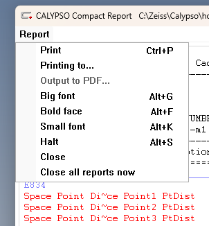

[hu...] Posted Thursday at 08:29 PM Share Posted Thursday at 08:29 PM Hi All, I am having an issue with turning the PDF on. it worked before, not sure what happened. Please see photos. Link to comment Share on other sites More sharing options...
[Lu...] Posted Thursday at 08:59 PM Share Posted Thursday at 08:59 PM Hello Hung, I believe you need to uninstall and reinstall the CALYPSO PDF printers. Please view this knowledge base article for the step-by-step procedure. https://portal.zeiss.com/knowledge-base?id=402098 1 Link to comment Share on other sites More sharing options...
[hu...] Posted Friday at 06:02 PM Author Share Posted Friday at 06:02 PM Please sign in to view this quote. Thank you! Link to comment Share on other sites More sharing options...
