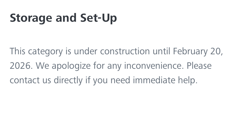

I have been debating this purchase for a while and of course today it became necessary. I went to look in to purchasing the FixAssist and I have discovered that it was removed from their shop. I am curious as to why this happened.
Edited
I cant say with certainty as that is a different department, but I don’t think it is permanently removed, I believe they are in the process of re-adding things after website work. I noticed this at the top of the accessories section and a few others, with things missing I am confident aren't being removed from the shop (like reference spheres).
