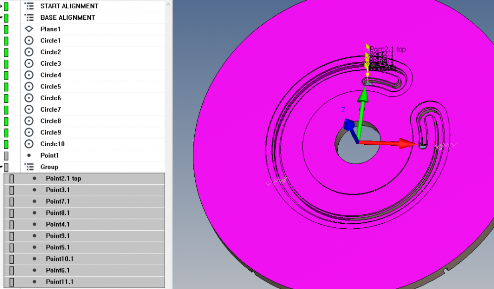

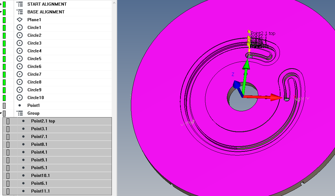

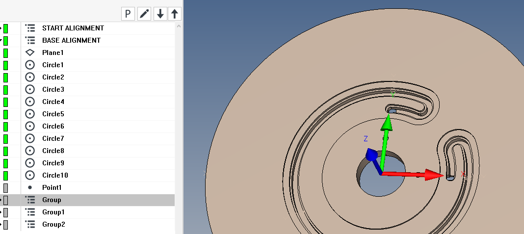

[Ca...] Posted January 26 Share Posted January 26 Recently upgraded from Calypso 2021 to 2025. Before features would show on model when I highlighted the whole group but now on 2025 version it will only show when I opened the group up. Link to comment Share on other sites More sharing options...

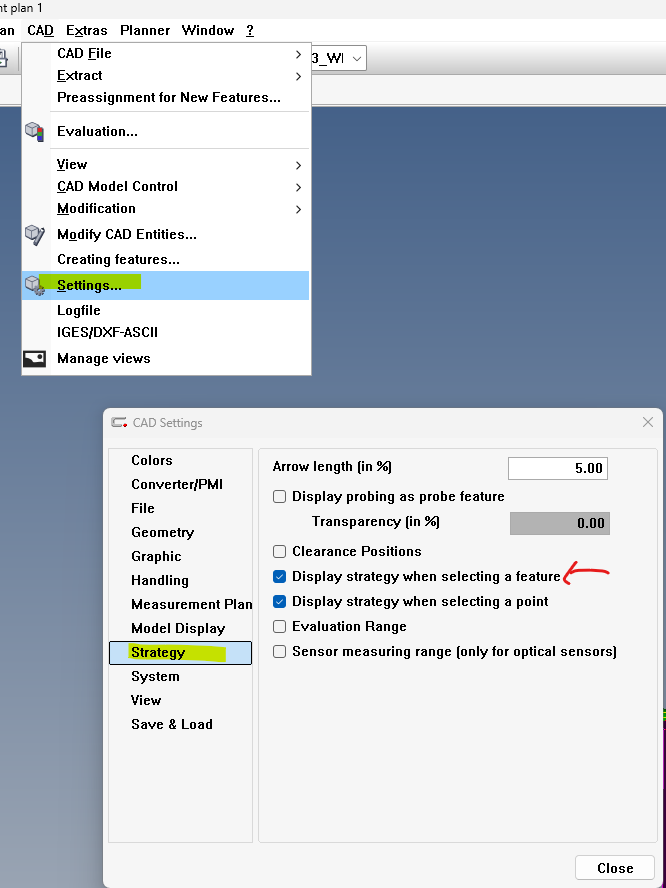

[Jo...] Posted January 27 Share Posted January 27 I would double check this setting is enabled. Link to comment Share on other sites More sharing options...
[Ca...] Posted January 27 Author Share Posted January 27 It's enabled and still nothing. I'm guessing the 2025 version did away with it. Link to comment Share on other sites More sharing options...
[Ma...] Posted January 28 Share Posted January 28 This is in fact "as designed" by development. I'm not happy with that change, but its said to be done for performance reasons. We are still trying to convince development to implement a switch for it so each user can choose for himself. Best Regards Marcel 1 Link to comment Share on other sites More sharing options...
[Ja...] Posted January 28 Share Posted January 28 Add my vote to those who would like it back please. Link to comment Share on other sites More sharing options...
