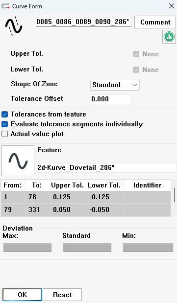

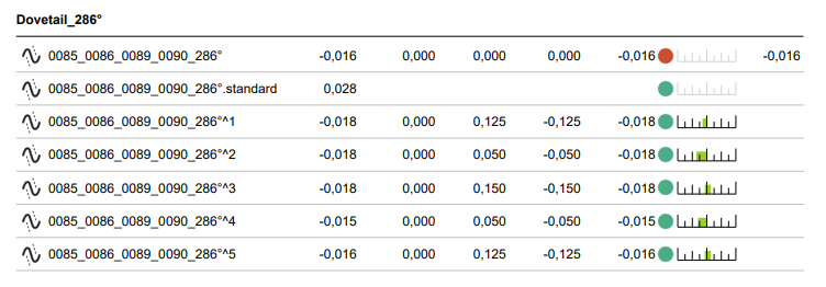

[Vá...] Posted 19 hours ago Share Posted 19 hours ago Hi, i am having an issue when i evaluate curve form individually under one characteristic that i have one line of values in protocol where i can't edit tolerances. Has anyone encountered this issue? Thanks in advance. Link to comment Share on other sites More sharing options...
[Ri...] Posted 14 hours ago Share Posted 14 hours ago What is your "Feature Tolerance"? You have "Tolerance from feature checked". Link to comment Share on other sites More sharing options...
