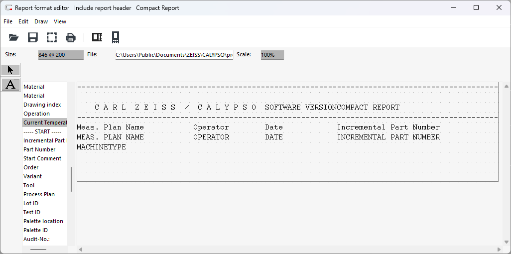

[Sh...] Posted January 27 Share Posted January 27 I’m on CALYPSO 2025 (V8.x) and cannot get the Report Format Editor (Resources → Design Custom Printout → Report header Compact Report...) to work correctly for the Compact Report. Not working with any report. The SYS / EDIT / START / OTHER lists do load normally, but: I cannot add any items to the header Clicking a field does nothing Items won’t place in the layout I’m not using PiWeb — the Compact Report must output as a TXT file, which is required for a downstream custom reporting process. What I’ve checked: Running as Master Measurement plan open before launching the editor Correct protform path: C:\Users\Public\Public Documents\Zeiss\CALYPSO\protocol\protform\ userfields.txt formatting (formatting errors can break editor behavior) Aware of Calypso 2025 cases where Windows permissions prevent editing Calypso base files despite proper Calypso permissions Verified the editor should still work per ZEISS printout customization documentation (Calypso 5.6+ covers newer releases including 2025) Has anyone else on Calypso 2025 seen this issue — where the lists load, but nothing can be added to the header? Link to comment Share on other sites More sharing options...
[Ch...] Posted January 27 Share Posted January 27 After some testing on my end I see the same issue as you in 8.0.08, the lack of ability to make edits and save when using the Compact Report editor. I went back to the previous versions of CALYPSO 2021 - 2024 and in all of these the editor functions as expected. CALYPSO 2025 seems to be the only one with this issue. I wonder - was this functionality removed intentionally or is this a bug within CALYPSO 2025. Typically I would suggest contacting your local ZEISS support so a potential bug report can be escalated. I will see if I can escalate this myself as you now have me curious. I'll let you know what I find. Link to comment Share on other sites More sharing options...

[Ch...] Posted January 28 Share Posted January 28 ZEISS Germany confirmed this is a known issue with the Compact Report Editor in CALYPSO 8.0.0 - 8.0.08. It will be resolved in the upcoming Service Pack update 8.0.12. Guide -> How to Download & Install CALYPSO Service Packs If you need a more immediate fix you could make the desired edits in a older CALYPSO version and transfer the file C:\Users\Public\Documents\Zeiss\CALYPSO\protocol\protform\cphead.gra to the CALYPSO 2025 directory or contact your local ZEISS support team to ask if they can request a temporary fix file to implement on your system stand alone. Hope this helps. 2 1 Link to comment Share on other sites More sharing options...

[Ch...] Posted March 5 Share Posted March 5 I was able to confirm CALYPSO Service Pack 8.0.12 does restore the ability to edit and save the Compact Report header. 3 Link to comment Share on other sites More sharing options...
