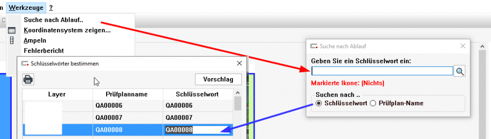

[Ka...] Posted February 2 Share Posted February 2 Hi, As far as I know, the ‘Barcode’ extension can only automatically insert the protocol header data from the barcode. To select a program with a barcode, use Autorun as Clark has already suggested. Restrict access rights for users as much as possible. We use the "Key-word" and "search-Dialoge" to identify "most-uniqe" our programs. Add the line [SEARCH DIALOG :'1170' '131' ] to the end of your *.arn file. The numbers are the position of this window. The user is not able to close it or to remove it using the access rights. Now you can assign a unique name to each test plan. To do this, use the Define key name function .If you now scan this key with a barcode scanner, it will be entered into the ‘search key mask’. Autorun will then jump to the icon regardless of which layer it is defined in. The user can now start the program selected in this way. Of course, after scanning a barcode, modern scanners can check it for plausibility, etc. in an external script/programme. It would also be possible to ask the user to scan additional barcodes relating to, for example, the clamping and the CMM machine. Only when everything is correct is the ‘search key’ entered in autorun. Therefore, it may make sense not to make this search key readable by humans; i.e. a 20-digit code or something similar so that manual entry is not easily possible. Surely just a detour, because there are at least two pieces of bad news: 1) The search key is NOT unique but ‘greedy’. Let's say your search key is QA1234-234. If you enter QA12, the FIRST search key found will be QA12. So QA12999-888 would then be active one. 2) Unfortunately, an icon will NOT be visible if more than one page full of icons is defined in a layer. In short: the window will not scroll. The user must therefore search for the activated icon in the layer using the mouse. Regards Karsten Link to comment Share on other sites More sharing options...
