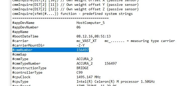

[is...] Posted Tuesday at 02:10 PM Share Posted Tuesday at 02:10 PM Hi All, I would like to get the cmm number to be saved in a variable. Can somebody share the correct PCM syntax? Thanks in advance. Link to comment Share on other sites More sharing options...
[Je...] Posted Tuesday at 02:26 PM Share Posted Tuesday at 02:26 PM variable=getRecordHead("dmesn") 3 1 Link to comment Share on other sites More sharing options...
