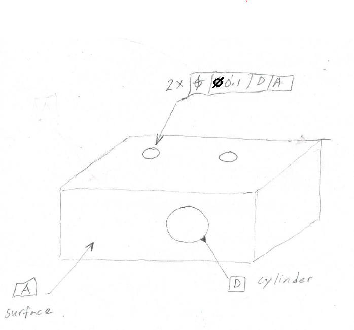

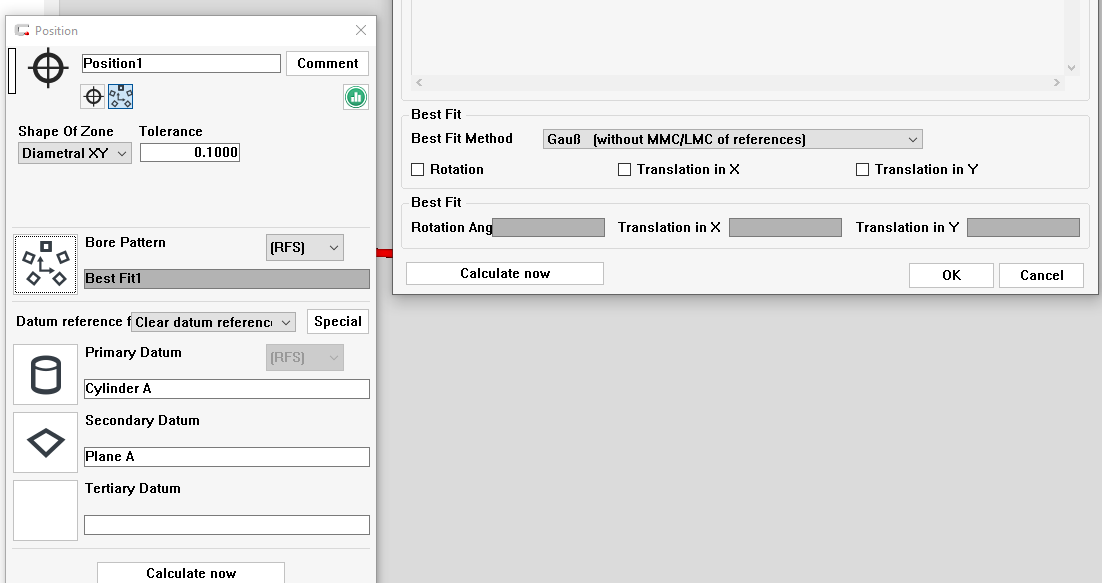

[Ca...] Posted February 3 Share Posted February 3 Hi, not sure if I'm using the right positional callout in calypso. Link to comment Share on other sites More sharing options...
[na...] Posted February 4 Share Posted February 4 (edited) Please sign in to view this quote. If this is to newer ISO then you would do each hole separate, if it's to older ISO, then what you have, plus check the box for rotation best fit. Edited February 4 Link to comment Share on other sites More sharing options...

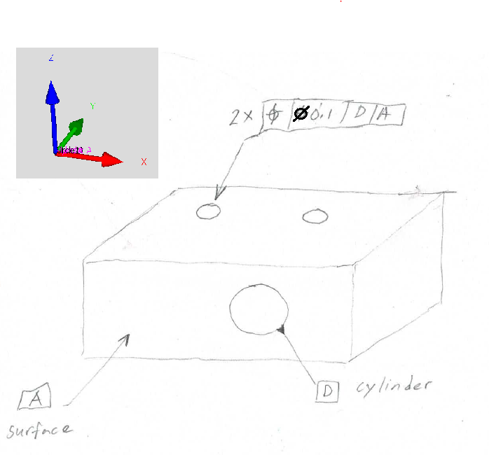

[Ca...] Posted February 4 Author Share Posted February 4 (edited) Is the rotation only possible on Y axis and not Z-axis? Edited February 4 Link to comment Share on other sites More sharing options...
[Ma...] Posted February 4 Share Posted February 4 I think there should be rotation in Y, but i don't see any option for this axis in your case. 1 Link to comment Share on other sites More sharing options...
