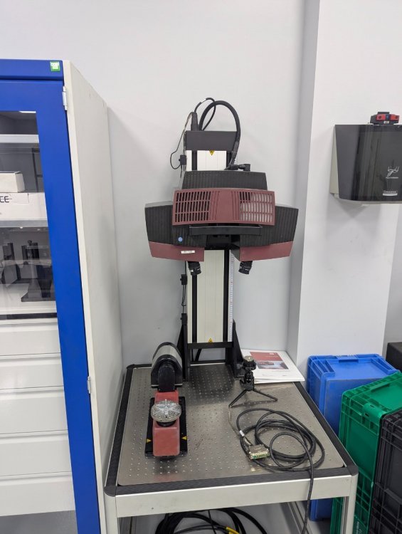

[Ch...] Posted Wednesday at 06:24 PM Share Posted Wednesday at 06:24 PM I have inherited an ATOS 3 Rev 2 scanner from our affiliate in Germany. We are in the US. It came with the a fixture plate table and a nice rotary(pic attached); However, I would like to find an arm like is pictured in my second attachment. I've reached out to Zeiss but have not received a response yet. Can anyone tell me what this mounting arm is called, or send me a link, or recommend any other ways to hold this thing like in the second picture? Also, if anyone wants to fill me in with some good tips and tricks about using the ATOS, that would be greatly appreciated. Link to comment Share on other sites More sharing options...

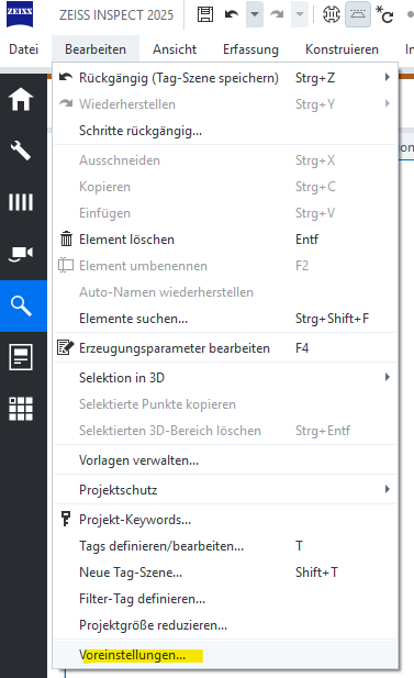

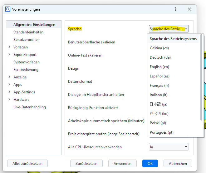

[Ch...] Posted Thursday at 01:20 PM Author Share Posted Thursday at 01:20 PM Much appreciated it. Don't tell Zeiss, but I already have a Keyence VL scanner, but we're really looking forward to trying the GOM out. We've been using some 1 mircon aerosol spray on the Keyence and I think it will work well with the GOM. My only issue right now is that the software is still in German. Can someone screenshot where the language section of the software is? If not, it looks like Ich lerne Deutsch sprechen. Link to comment Share on other sites More sharing options...
[Jo...] Posted Thursday at 02:01 PM Share Posted Thursday at 02:01 PM For me a paintprush is vastly superior to any spray just because the distribution is so much better especially with narrow grooves and small details. Hope those screenshots help with your language problem. 1 Link to comment Share on other sites More sharing options...
