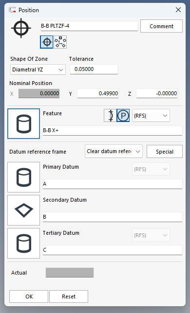

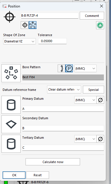

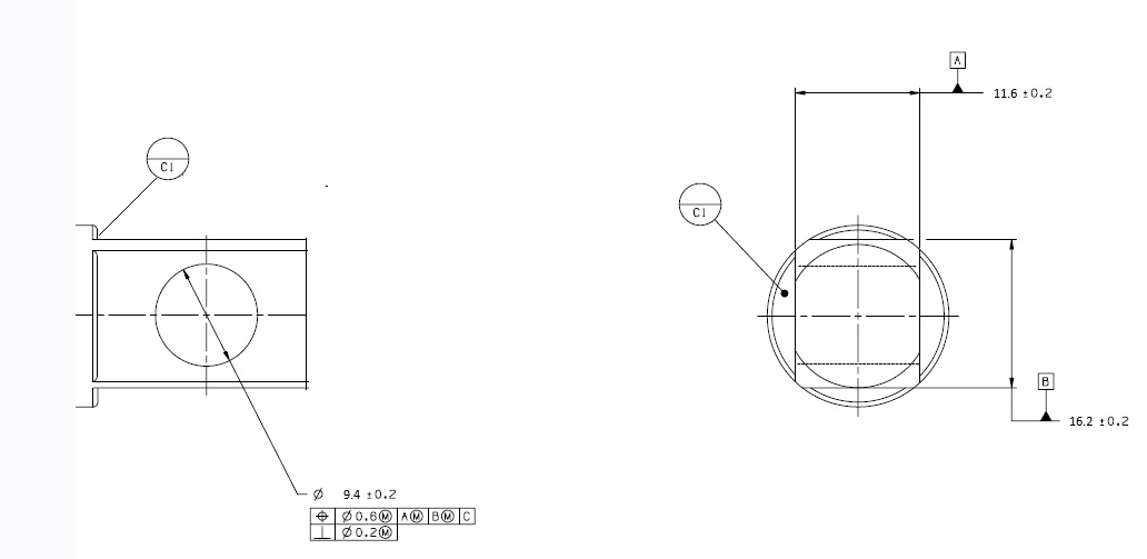

[Ra...] Posted Thursday at 01:34 PM Share Posted Thursday at 01:34 PM See attached. The alignment is symmetry plane of -A- and -B- and then -C- point tertiary. Question I have have is how to get the MMC into the True postion characteristic for -A- (11.6 width) and -B- (16.2 width) regarding the 9.4mm thru hole? I currently have the symmetry of -A- plane as primary and symmetry of -B- plane as secondary. MMC is not an option in the characteristic with the symmetry plane alignment. Thanks! Link to comment Share on other sites More sharing options...

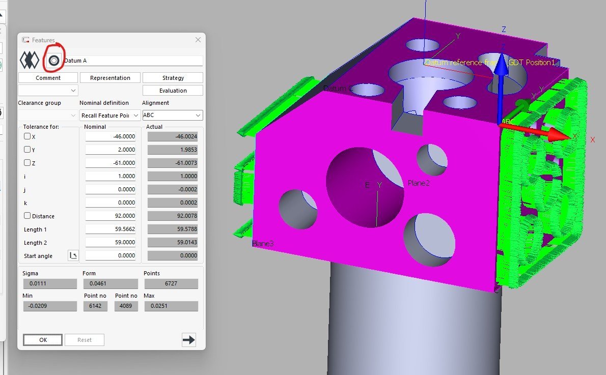

[Cl...] Posted Thursday at 01:48 PM Share Posted Thursday at 01:48 PM Constructing a Symmetry plane should allow you to us MMC. Link to comment Share on other sites More sharing options...

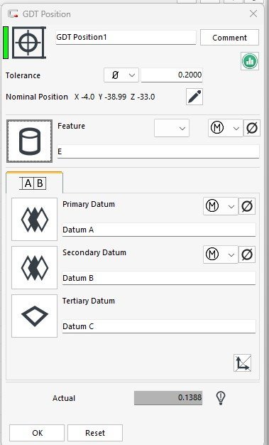

[Jo...] Posted Thursday at 01:55 PM Share Posted Thursday at 01:55 PM The Symmetry plane does allow MMC if it is the feature for evaluation, but the software doesn't allow MMB on the DRF. I'm not even sure MMB on Datum A would even do anything since it is parallel to the axis of the bore. 1 Link to comment Share on other sites More sharing options...

[Jo...] Posted Thursday at 02:16 PM Share Posted Thursday at 02:16 PM I thought I had a workaround for you that I had seen before, but the software still doesn't allow it. The workaround was to create a perpendicular for each datum, then create two theoretical circle features and use PCM to right-click on the diameter box and add the get actual for the length of the perpendiculars. The thought was that it would allow you to add the modifiers to the circles, but it is still grayed out 😞 1 Link to comment Share on other sites More sharing options...

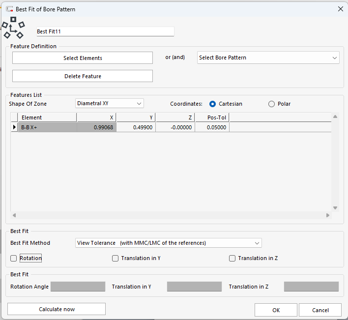

[Ch...] Posted Thursday at 02:24 PM Share Posted Thursday at 02:24 PM if I had to absolutely do this, I would end up creating a theoretical cylinder for -A- with data that matches the symmetry plane, and probably require a best fit position to get MMC of A, I think I have done it a few times actually. Link to comment Share on other sites More sharing options...

[Ma...] Posted 6 hours ago Share Posted 6 hours ago That's something i'll try on monday. Symmetry plane should give MMB - constructed symmetry from planes won't. Link to comment Share on other sites More sharing options...
