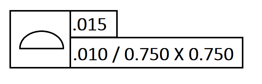

[Ca...] Posted February 10 Share Posted February 10 I've seen these callouts before; I understand what the intent is. How would I check this in Calypso? Link to comment Share on other sites More sharing options...
[Ri...] Posted February 10 Share Posted February 10 Can you use Flatness instead? Otherwise there is not directly easy way to achieve this. Link to comment Share on other sites More sharing options...
[Ca...] Posted February 10 Author Share Posted February 10 Not really? It's a few contour surfaces. Link to comment Share on other sites More sharing options...
[Pe...] Posted February 10 Share Posted February 10 I've come across a similar callout on some of our contoured parts. As far as I know, there isnt a way to do that in calypso. I think there might be in other softwares which is why someone got it in their head that is was ok to add it to the print. The solution we came up by working with the customer was a specific number of .010 "box" profiles that were located at certain areas to ensure that there was sufficient overlap of our squares, and then one .015 profile that encompassed the entire surface. Link to comment Share on other sites More sharing options...
[Ca...] Posted February 10 Author Share Posted February 10 Well, thanks anyway. Maybe someone will have a suggestion. Link to comment Share on other sites More sharing options...
[Ch...] Posted February 10 Share Posted February 10 rare callout, they should just apply a stack up and let you do a total measurement and report, but if I had to do this I would just measure multiple 0.75 x 0.75 grids and report multiple profiles. Sure there could be many 'overlap' areas, but it's best we can do... Link to comment Share on other sites More sharing options...
[Ca...] Posted February 11 Author Share Posted February 11 (edited) Any suggestions on creating grids of a known size on cylinders, cones, and toruses? Edited February 11 Link to comment Share on other sites More sharing options...
[Ch...] Posted February 11 Share Posted February 11 um yeah, chat gpt, lol, they can probably make an excel for you to use any time ... Link to comment Share on other sites More sharing options...
