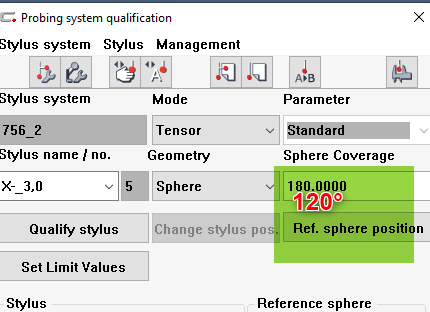

[Da...] Posted February 11 Share Posted February 11 327 Good morning, I've purchased a probe with a 0.3 mm diameter (extremely small), and when I calibrate it, the result is insufficient. I think it's because during the calibration process, the probe catches on the probe shaft. Where can I change the settings so that it calibrates successfully? Thank you very much. Link to comment Share on other sites More sharing options...
[Ch...] Posted February 11 Share Posted February 11 Hi David, you must change the opening angle mak it smaller, maybe 120° Link to comment Share on other sites More sharing options...
[Da...] Posted February 11 Author Share Posted February 11 35 Thank you so much, I couldn't find it... Link to comment Share on other sites More sharing options...
[Da...] Posted February 11 Author Share Posted February 11 Please sign in to view this quote. Hello again, I'm still having problems and it's still giving me insufficient calibration. I've even lowered the degrees to 90, but when the dial makes the first circular sweep, it still hits the stem... I don't know if that's the problem. I don't know if I should also increase the limit values, the sigma, and so on... Link to comment Share on other sites More sharing options...
[Ke...] Posted February 11 Share Posted February 11 What probehead are you utilizing? If it is an xxt system, changing the angular coverage will not have the desired effect, your only option would be to acquire a smaller aphere so that the probe does not hit. Link to comment Share on other sites More sharing options...
[Da...] Posted February 12 Author Share Posted February 12 Please sign in to view this quote. 167 Good morning, Kevin. I think that's my problem... My sphere is 30 mm in diameter. What sphere do you recommend so I can perform a successful calibration? Link to comment Share on other sites More sharing options...
[Ad...] Posted February 12 Share Posted February 12 8 mm Link to comment Share on other sites More sharing options...
[Da...] Posted February 12 Author Share Posted February 12 Thank you Adrian Link to comment Share on other sites More sharing options...
[Da...] Posted 18 hours ago Author Share Posted 18 hours ago Please sign in to view this quote. Hi Adrian, I hope you can help me with this; I bought a sphere with a diameter of 8 mm with the stem that I use on the sphere with a diameter of 30 mm, and when calibrating the small probe with a diameter of 0.3 mm, I get the following. "The probe calibration could not be performed with this standard sphere. Check the radius of the standard sphere's stem. It has been detected that the stem radius of the standard sphere is more than 60 percent of the radius of the standard sphere." I should also mention that the master calibrated this new 8mm diameter sphere without any problems. What is the diameter of the stem on your 8mm diameter sphere? Thanks in advance. Link to comment Share on other sites More sharing options...
