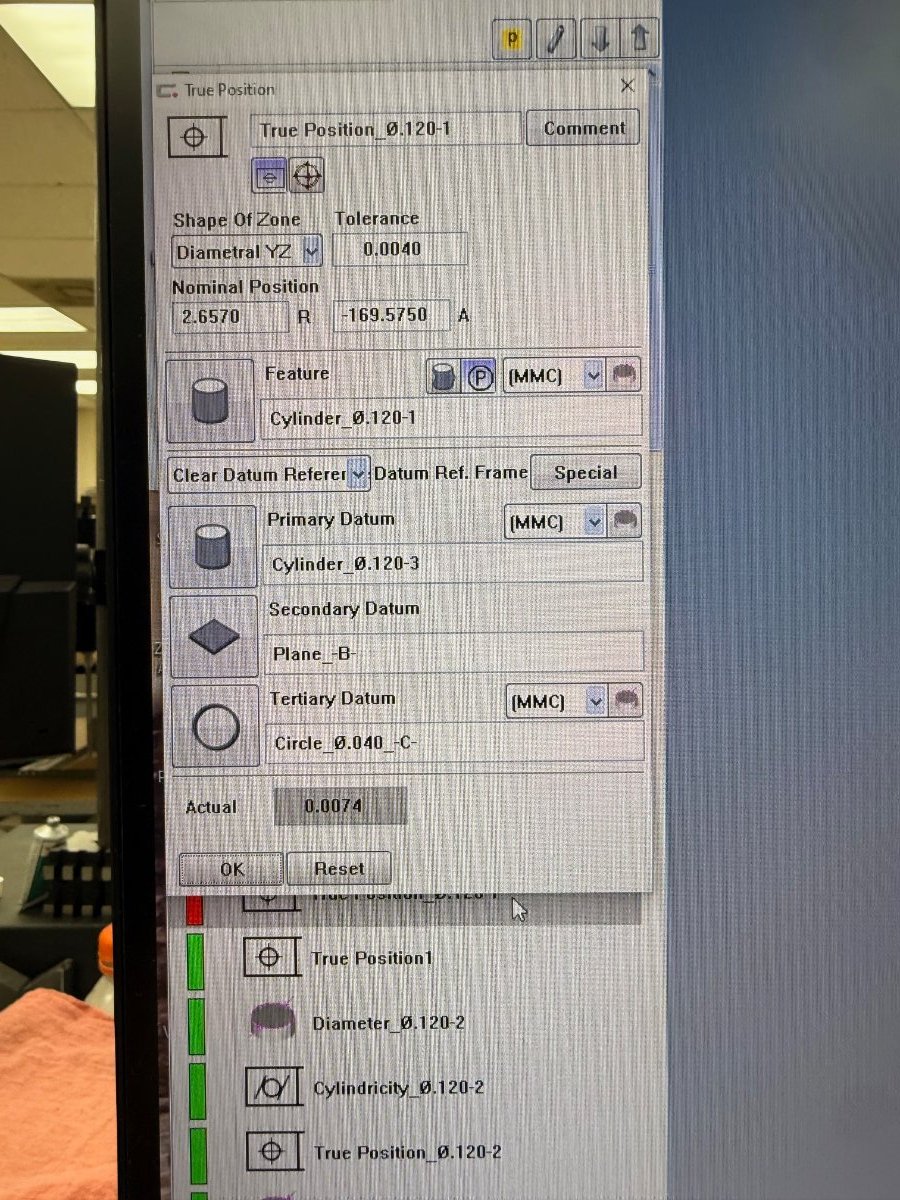

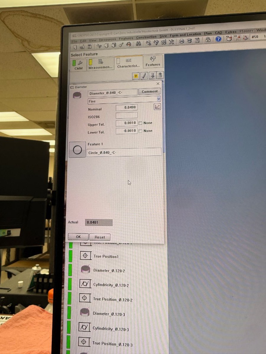

[Ka...] Posted February 13 Share Posted February 13 Hello everyone, I’m having an issue with my Zeiss Contura G2 when evaluating true position with MMC, and I’m hoping someone can help me understand what I might be missing. The drawing calls out true position with MMC. In Calypso, I applied MMC to the datums in the true position characteristic. However, when I generate the report, it looks like the CMM is only calculating the MMC bonus from the measured feature itself, and not from the primary or tertiary datums. I’ve attached screenshots for reference. Does anyone know why this is happening or what setting I may be overlooking? Thanks in advance for any help. Link to comment Share on other sites More sharing options...

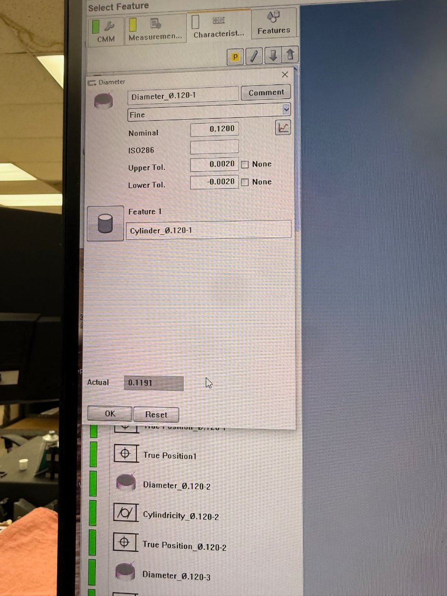

[Ka...] Posted February 17 Author Share Posted February 17 Tom, so you’re saying that in my case the cylinder diameter Ø.120-.001 is a datum feature at MMB and therefore does not provide any additional bonus tolerance. That’s honestly the first time I’m hearing this. However, if you look at my screenshots, the issue I’m running into is that the CMM is only calculating bonus from the datum feature. It is not applying any bonus from the primary or tertiary datums. At the same time, the CMM is calculating feature MMC, even though you’re saying the datum feature should be treated as MMB. That mismatch is really the core of my confusion. Link to comment Share on other sites More sharing options...
[To...] Posted February 17 Share Posted February 17 (edited) Referring to the position window, the Feature uses the feature's tolerance to calculate the max material condition, and the difference from the actual to the mcc is added to the position tolerance. The Datum Features do not. They shift and nothing on the report shows you what it did. Edited February 17 1 Link to comment Share on other sites More sharing options...
[Ka...] Posted February 17 Author Share Posted February 17 Hey Tom, I did a bit of research on MMB and also spoke with our engineering team—interestingly, they hadn’t even heard of it. i will have to educate myself and our team a bit better about this . I’m still a bit stuck though. As you can see in picture #3 from my original post, for the true position callout I set the CMM to use MMC on features, and both datums were also set to MMC. Shouldn’t the report still show the additional bonus tolerance if everything is set to MMC? Or does the CMM automatically recognize this as MMB, which is why it’s not adding the extra bonus tolerance even though MMC is selected? 1 Link to comment Share on other sites More sharing options...
[Ze...] Posted February 17 Share Posted February 17 Calypso has the incorrect terminology for datum modifiers in the dialogue box. It's always been shown as MMC, but the correct term is MMB when applied to a datum feature. MMC = Maximum Material Condition and is applied to the considered feature of size in the FCF. MMB = Maximum Material Boundary and is applied to the datum/datums in the FCF. MMB provides no "bonus" to the feature itself. It applies mobility/shift to the datums depending on their size relative to their limits. This is not reported in Calypso. The calculations are not a direct tolerance that can be applied to the feature itself. 2 Link to comment Share on other sites More sharing options...
