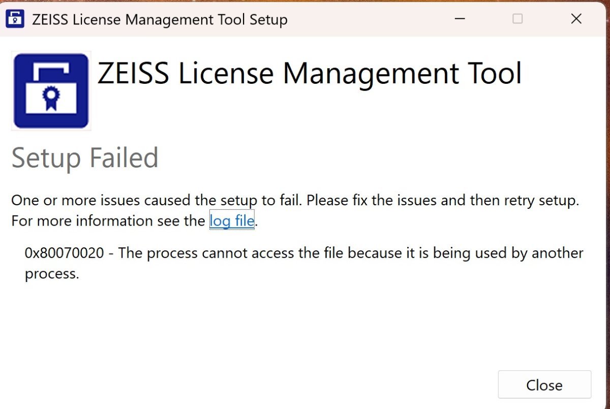

[To...] Posted February 16 Share Posted February 16 I get the following error when I try to load ZLMT on a new laptop running Win11 Pro. I have also attached the log file. I also get the exact same error when trying to install on another desktop running Win11 Pro. TIA ZEISS_License_Management_Tool_20260215132333.log Link to comment Share on other sites More sharing options...
[To...] Posted February 17 Author Share Posted February 17 Update. Seemed like something was up the ZLMT program that came on the USB. Even though it was the latest version, I downloaded a fresh copy from the portal. This time, I tried having the dongle installed and it worked. Next, I went to my desktop, inserted the dongle, used the ZLMT program from the USB and got the same error as above. I downloaded a fresh copy from the portal and then it worked. So, I don't know if having the dongle inserted really mattered. All good now. 1 Link to comment Share on other sites More sharing options...
[An...] Posted February 19 Share Posted February 19 Should not need the dongle to install the licensing software itself. I have seen a few cases were the install files can get corrupted and fail to install as you mentioned. I would also make sure you are extracting from the zip file then install the with the extracted files and not just run it from the zip file itself. Link to comment Share on other sites More sharing options...
