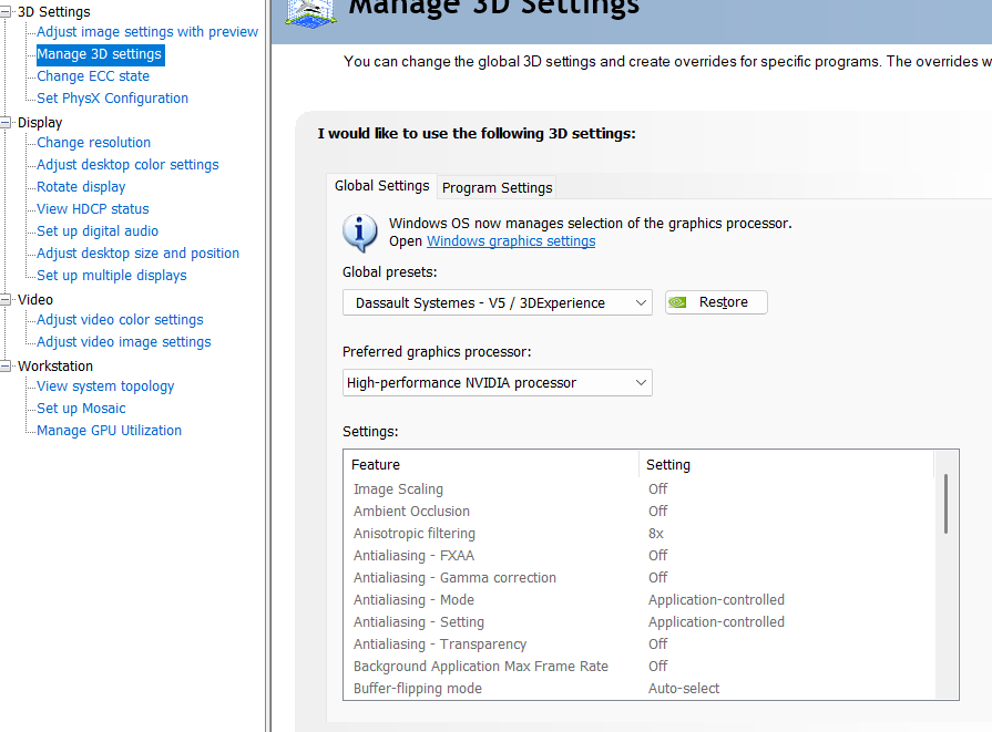

Slow Simulation Mode Zeiss Calypso- how to fix it - dell precision 7600 7800
1. BIOS - go to Display -> Hybrid Graphic/Advanced Optimus then -> Enable hybrid... must be ON also Discrete Graphic.. must be ON
2. Power Mode in Windows settings change from "save mode" to ''Hight Performance"
3. Install NVidia drivers vs ''537.58-desktop-win10-win11-64bit-international-dch-whql'' - on those drivers the calypso has been tested
4. NVidia settings as below then Apply
5. Enjoy
