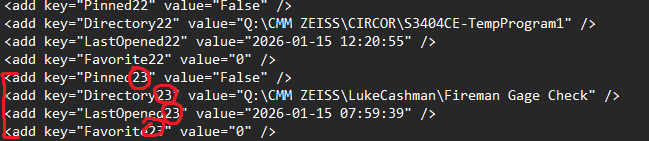

[Lu...] Posted February 17 Share Posted February 17 Hello, i have tried searching this forum as well as the calypso help menu yet i cant seem to find any information. Is there a way to remove a program from the "recently used" menu that opens programs? I have some broken programs that appear in there (whether i have since moved the program to a different location which results in the program appearing twice, or the program is incomplete/used for another CMM, etc.) and i don't want someone to accidentally open those programs instead of the program they intend to run. I cant seem to find a way to remove the program from the recently used menu, could someone tell me how? Thanks! Link to comment Share on other sites More sharing options...
[Ri...] Posted February 17 Share Posted February 17 Please sign in to view this username. Either delete the user.config file located in "C:\Users\<USERNAME>\AppData\Local\Zeiss\CALYPSOFileDialog.exe" or modify it to remove the specific one you want removed. Link to comment Share on other sites More sharing options...
[Lu...] Posted February 17 Author Share Posted February 17 Thank you this worked. For anyone else wanting to know exactly what i did, i shift clicked the file to open in notepad. and for the favorite item i didnt want i deleted the 4 lines that correspond to the favorite. then for all lines below i fixed the count to be in order (in the attached photo, if i deleted the "23" i would have to go to the next favorite and change it to 23 to fill in the gap, and repeat for all later listings) let me know if you have more questions 1 Link to comment Share on other sites More sharing options...
