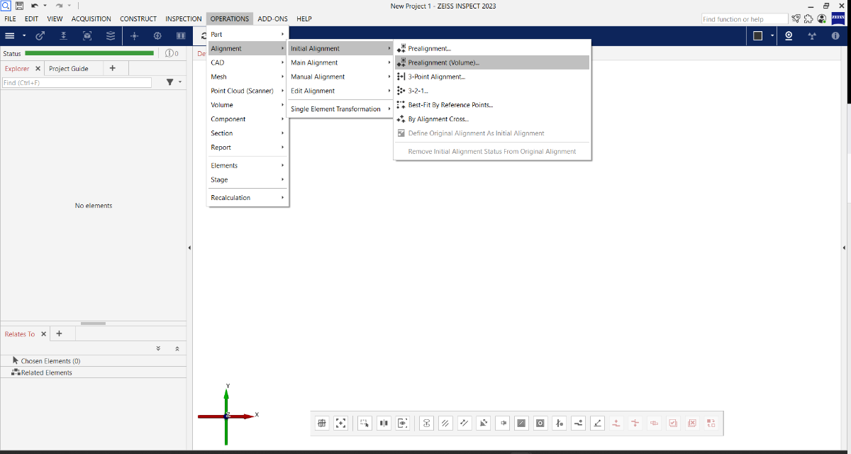

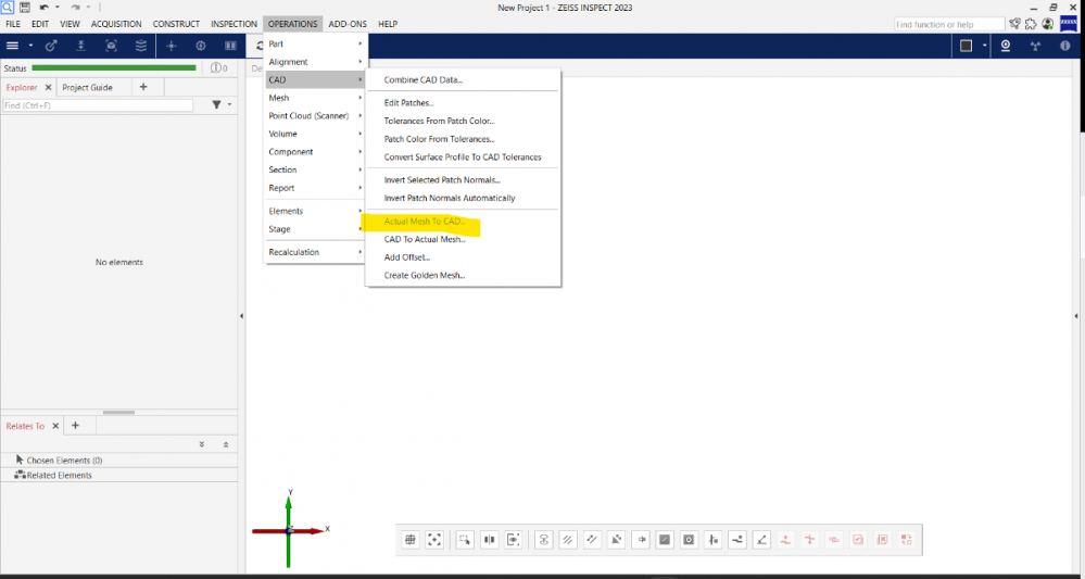

[DW...] Posted February 19 Share Posted February 19 (edited) Please sign in to view this username. You can align a volume to a CAD, see screenshots. If you do not have a CAD to align your volume, create a mesh from your volume, align that normal to the global axes using a 3-2-1 alignment, and then turn the actual mesh into a "CAD". Once you do that, delete the 3-2-1 alignment and the CAD stays oriented normal to the axes. From this, do an initial alignment>prealignment (volume). Now your volume is aligned normal to the axes so you can clip through normally. Edited February 19 Link to comment Share on other sites More sharing options...
[Na...] Posted February 24 Author Share Posted February 24 (edited) thank you for your answer. now i have a CAD generated from the Volume 1 mesh (actual to CAD) that is aligned with 3-2-1 to the global axis. The volume 1 is still somewhere else(doesnt follow the mesh). Nevertheless, i still have a Volume 2 with coresponding Mesh and no alignment. How do i align the Two volumes, or the Two meshes, or CAD to Mesh so that in the end I get some aligned data from this two different Volumes (same part, measured at different time intervals) so that i can make a volume difference (substraction) Volume 1 - Volume 2 to be able to extract the difference (volumetric) as a new Volume which is my end goal? Best regards, Edited February 24 Link to comment Share on other sites More sharing options...
[DW...] Posted February 24 Share Posted February 24 Please sign in to view this username. I am not sure I am following exactly what you are trying to do, but after creating the "CAD" you align the volume to the "CAD" by doing an initial alignment>prealignment (volume). Link to comment Share on other sites More sharing options...
