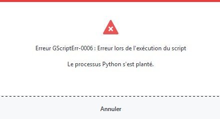

[Cy...] Posted February 20 Share Posted February 20 Hi all, When i want to use De-Warp by Apps => execute scripts => De-Warp => Voxelyser, a message appears "Python process crashed". Do someone know how to resolve that issue please ? Many thanks Link to comment Share on other sites More sharing options...
[Na...] Posted February 20 Share Posted February 20 Hi Cyril, you can find the De-Warp functions integrated into Inspect 2026 under Construct -> Deformation Model -> Voxel Deformation Model and Operations -> Mesh -> Virtual Clamping -> Remove Warpage Maybe there is an error with python because of security restrictions. You could test by running another script. Nanno Link to comment Share on other sites More sharing options...
