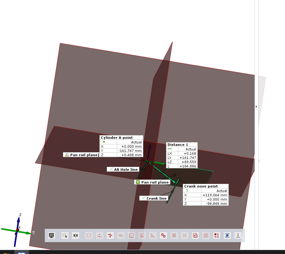

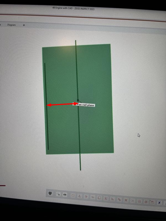

[Vi...] Posted February 21 Share Posted February 21 Hello Community, Need help to measure below distances in Mesh without the CAD, I was able to create the lines using the center of the axis of two holes on the top plane but was not able to figure out how to measure the perpendicular distances between the lines. (see below) Link to comment Share on other sites More sharing options...

[Vi...] Posted February 23 Author Share Posted February 23 Hello, I added a local datum system as can be seen below and got the xyz coordinates for the points on the line. Does that mean the perpendicular distance in Z is (88.848+0.488) = 89.336 mm and perpendicular distance in Y is 161.747mm? Is that a fair statement or am I interpreting it incorrectly? Link to comment Share on other sites More sharing options...
[Ma...] Posted February 24 Share Posted February 24 For us to be sure we need to know how you've created this alignment. You should have Cylinder A as main ( first ), then you can have point from Crank line used as rotation and X origin. You can make point from line at beggining, end and middle ( or any by given % ) Also your actuals could be wrong - have you selected this created alignment in that window, where you setup tolerances or you have left "global alignment"? Link to comment Share on other sites More sharing options...

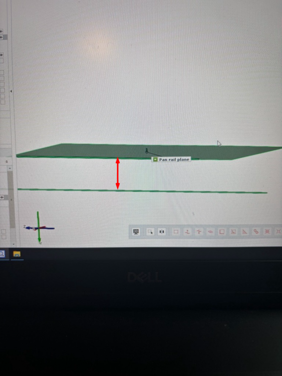

[Jo...] Posted February 24 Share Posted February 24 (edited) Please sign in to view this quote. Now i get what you want. Would`nt projecting the lines (or one line) in the right planes solve the problem then? ... and afterwards the shortest distance is what you are looking for. Edited February 24 Link to comment Share on other sites More sharing options...
[Ma...] Posted February 24 Share Posted February 24 I've tested and if you want to measure perpendicular from CylinderA to CrankLine, then make a point from a line -> select Crank line -> select which point you want. Now just make perpendicular distance -> select point -> select CylinderA -> now report your YZ - this should be your value ( or XYZ to get 3d distance ) Link to comment Share on other sites More sharing options...
