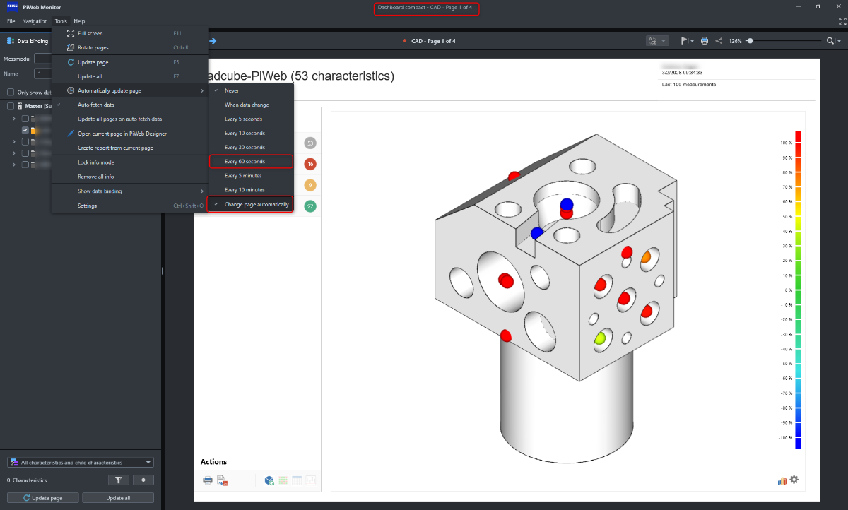

[Do...] Posted March 2 Share Posted March 2 Hi, I am unfortunately not familiar with the display of Minitab. PiWeb offers a pre-made dashboard report. There is also the option to automate page switching and data retrieval. Link to comment Share on other sites More sharing options...
