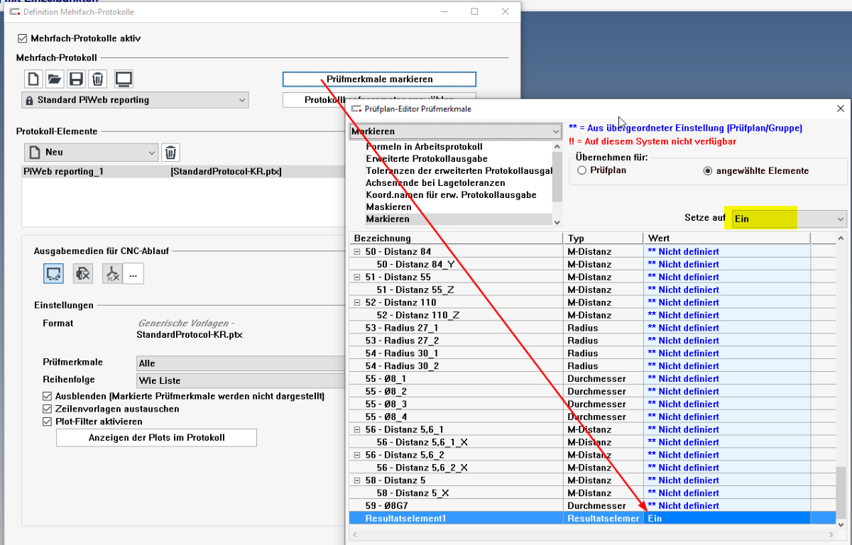

[Ka...] Posted March 10 Author Share Posted March 10 Moin, A hack to write the program runtime to the piWeb database in a ‘visible’ and thus evaluable form: The result element with the following formula returns the number of seconds. This is somewhat vague, as it includes the actual runtime including PiWeb report generation. This is therefore a few seconds longer than ${Qdb.Property("MeasurementDuration")} in the piWeb form. (val(subStr(getRecordHead("durationofrun"),4,5)) * 60)+ val(subStr(getRecordHead("durationofrun"),7,8)) The return value of "durationofrun" is something like hh:mm:ss,?. The function subStr grep out the value of mm , convert is to a integer and multiply with 60. Similar for seconds. Now, it needs the real hack: We do not want to see the "result element" within our PiWeb report. To achieve this, select the test element. It will be executed but not displayed in the log. The runtime is now visibly transferred to the PiWeb database. It can now be exported to Excel. Admittedly, this is not exactly practical either. But it is better than looking through individual logs. Link to comment Share on other sites More sharing options...
