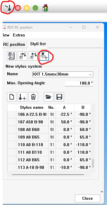

I have a situation where I set-up my Planner-Offline seat over a year ago, and out of the 30something probe positions I use often, maybe only 5-10 get used daily.
This morning I chose one of the styli that rarely get used. I'm assuming when i created the offline seat and imported the stylus systems, I chose the incorrect "Position of the stylus before rotation" (I think that was the name of the pop-up window when performing your first import from SSC.)
Anyway, my question is, is there any way to easily fix this incorrect angle (on this single styli)? The stylus should be normal to the -Y direction, not +Y. I went in to the Stylus System Manager and changed the Y vector to the correct integer, but I don't know how to adjust the actual geometry to match the physical CMM (Contura G2).

You should be able to go into "Rotate Stylus to new position" button, go to Styli list, go to the probe you're having an issue with Update the A and B angles, click "Creates a new stylus system button, click update, then ok twice. This window is how I add new probes to my planner seat.
