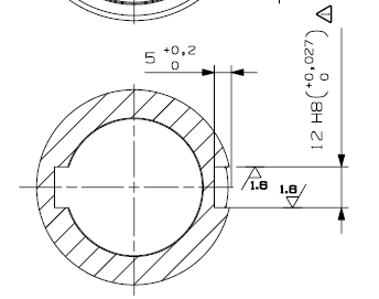

[Fe...] Posted March 4 Share Posted March 4 Calculate the distance between the walls of this groove, which must also be symmetrical, and calculate the fillet length. How can I do this? Link to comment Share on other sites More sharing options...
[Fe...] Posted March 4 Author Share Posted March 4 "I would like to know how to calculate the symmetry of the faces of this groove." Link to comment Share on other sites More sharing options...
[Ma...] Posted March 4 Share Posted March 4 Do you need datum from that symmetry? Are we talking about symmetry for width or R<->R of that groove? Link to comment Share on other sites More sharing options...
[Fe...] Posted March 4 Author Share Posted March 4 The cavity is the one on the right". is it sufficent? Link to comment Share on other sites More sharing options...

[Ma...] Posted March 4 Share Posted March 4 This can be done with "Slotted Hole" - either nominal or fitted element. To obtain this 12 H8 just call width. I think it's only as section. If you want to cover whole planes, then make two planes, then symmetry from them and then use GD&T on that symmetry to obtain width. Link to comment Share on other sites More sharing options...
