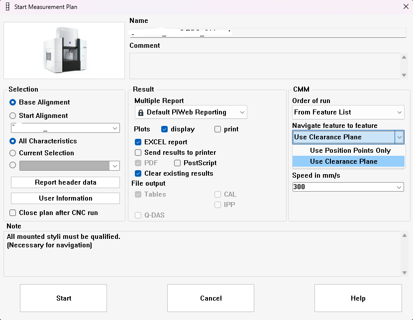

[Si...] Posted March 5 Share Posted March 5 Hey everyone, We have programs that do not use automatic path generation. Each time I start the program, about 5 to 10 seconds later I get this warning. Is there a way to disable it? Thanks in advance The Text in Picture says : Collision risk Elements for alignment must be measured, but automatic path generation is not activated. Link to comment Share on other sites More sharing options...
[Ro...] Posted March 16 Share Posted March 16 When I see that pop up, it is because I do not have clearance plane selected. 1 Link to comment Share on other sites More sharing options...
