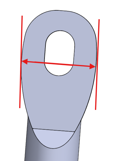

[Da...] Posted March 12 Share Posted March 12 Hello everyone, I'm very new to this software, and hopefully someone could help me out. How do i get a max/min distance from one side to the other? Since i can't create a plane because of the curved sides, i'm having difficulties getting this measurement. Link to comment Share on other sites More sharing options...
[Ma...] Posted March 12 Share Posted March 12 (edited) I would use caliper point - either disc or edge - depending on shape of sides. Also there can be a way with section Edited March 12 Link to comment Share on other sites More sharing options...
[No...] Posted March 23 Share Posted March 23 You can use caliper disctance or two single disc touch points. But in both cases it is up to you to define the measuring direction. If the element shown is aligned, you can select X/Y/Z axis in the dialog, otherwise you'll need a reference element to define that direction. It will NOT determine the smallest distance automatically! You can also use caliper distance on sections, so it will only measure in the defined section plane. Link to comment Share on other sites More sharing options...
