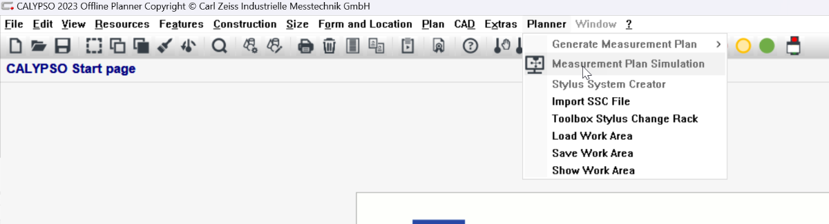

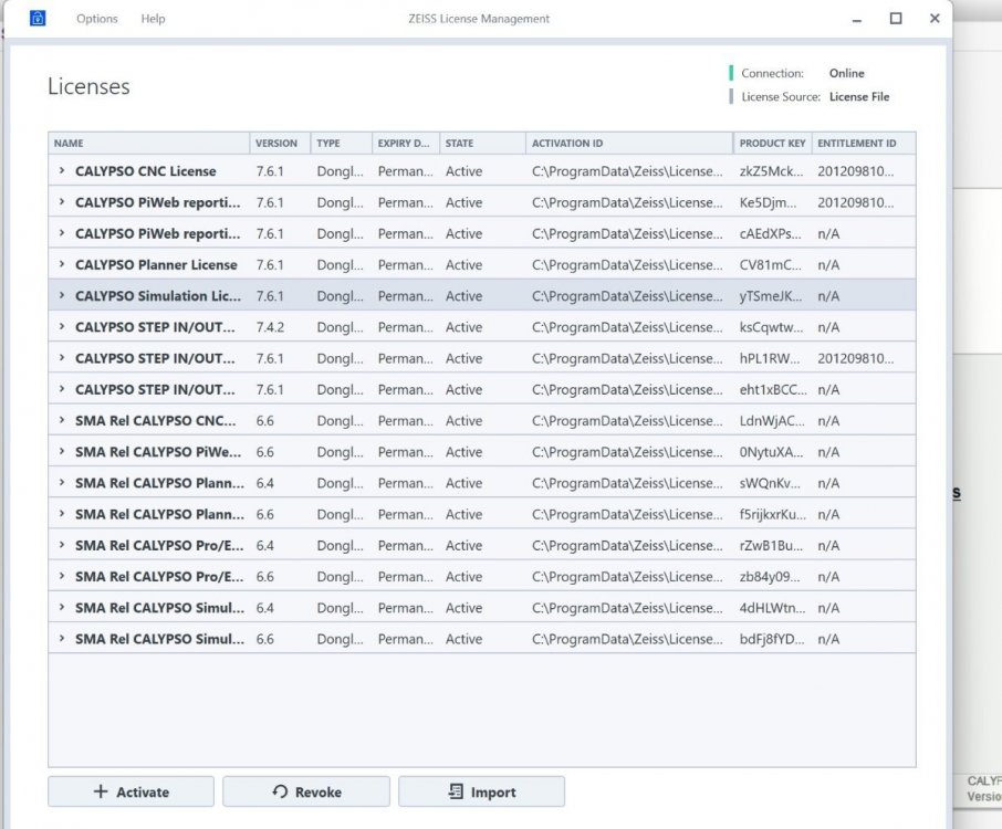

[Ju...] Posted March 16 Share Posted March 16 I can not get my measurement plan simulation to run it is greyed out. Is this a license issue or a network problem? The Measurement plan simulation does work on my assigned computer but will not work on any other computer that runs CALYPSO 2023. Attached are pictures of my licensing and attached is the picture of the Planner tab that is greyed out and in-active. Link to comment Share on other sites More sharing options...
[Ro...] Posted March 16 Share Posted March 16 You probably need to enable the license itself, within Calypso. Extras -> Settings -> Licenses. Link to comment Share on other sites More sharing options...
[Cr...] Posted March 16 Share Posted March 16 If it's not at planner seat, make sure Simulation only is checked in the CMM settings under Extras-Settings-CMM Link to comment Share on other sites More sharing options...
[No...] Posted March 16 Share Posted March 16 (edited) Calypso knows two basic licenses: Calypso CNC and Calypso Planner/Sim. Both are mutually exclusive, which means they cannot both be active at the same time. So if you want to switch over to Planner on a live CMM, you should deactivate the CNC license and activate the Planner/Sim license in the Calypso license tab first, then restart Calypso. If it still doesn't work (or you don't see a Planner/Sim license on the CMM), you need to copy the license file from the working Planner PC to the CMM. It should be somewhere in C:\Program Data\Zeiss\Licenses or somethinmg like that. Edited March 16 1 Link to comment Share on other sites More sharing options...
[Sv...] Posted March 17 Share Posted March 17 When copying the license file, it is important to copy it to a USB stick or similar device and then activate it on the other computer using ZLM, rather than simply copying it into the directory. 1 Link to comment Share on other sites More sharing options...
[No...] Posted March 17 Share Posted March 17 Please sign in to view this quote. Surely a requirement of the new licensing model? Under the old one it was sufficient to simply copy it. Anyway, good to know! Link to comment Share on other sites More sharing options...
[Sv...] Posted March 17 Share Posted March 17 Please sign in to view this username. Yes, it is. I had problems with the files and contacted Zeiss, and they explained these steps. Link to comment Share on other sites More sharing options...
