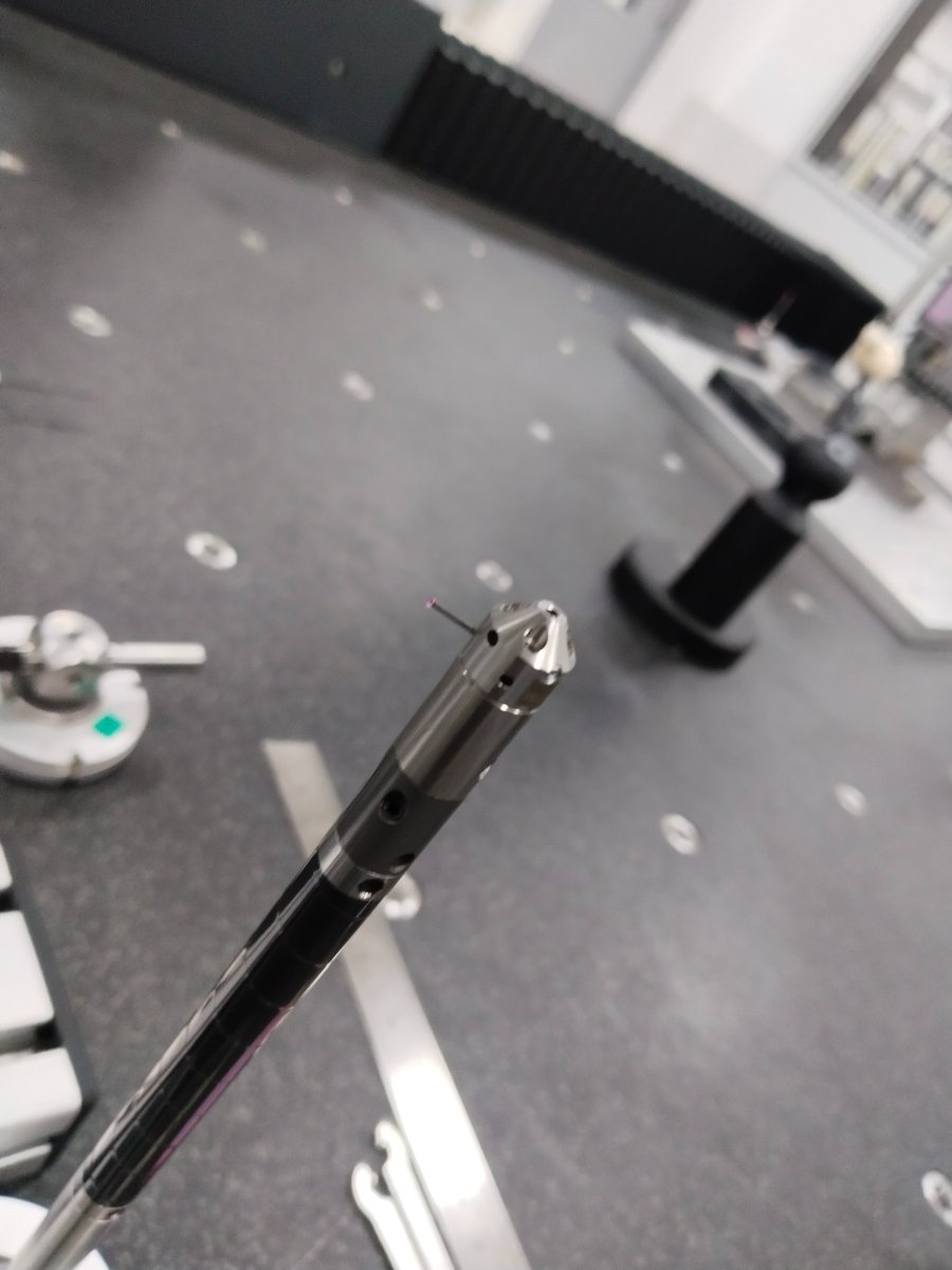

[SH...] Posted March 18 Share Posted March 18 While offline programming, styli without thread is not available in the stylus system creator data base. I have to figure out a simulation using styli without thread. I have attached the photo of the styli Link to comment Share on other sites More sharing options...

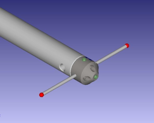

[No...] Posted March 18 Share Posted March 18 See examples: Link to comment Share on other sites More sharing options...
[SH...] Posted March 18 Author Share Posted March 18 Waw looks like dime a dozen ...👍 Link to comment Share on other sites More sharing options...

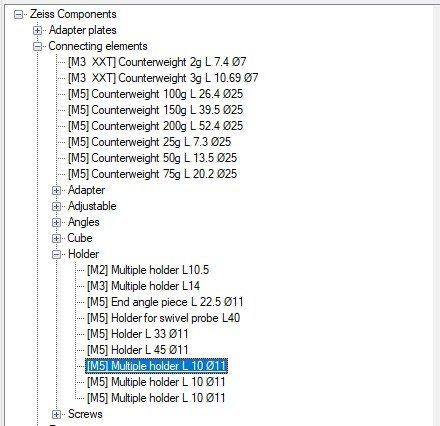

[To...] Posted March 19 Share Posted March 19 What I noticed in 2025 was that the no thread stylus assembles with the flat end of the stylus at the OD of the holder and not inside the holder making it appear longer than it would be on a real assembly. For example, a 25mm long stylus extends 25 out of the holder. Link to comment Share on other sites More sharing options...

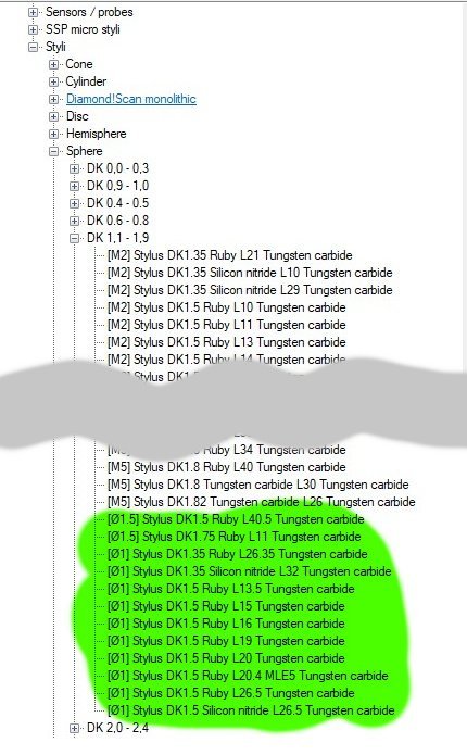

[Ch...] Posted March 26 Share Posted March 26 You can also create any desired non-threaded stylus using the Free Generic Stylus and Modify Properties. Link to comment Share on other sites More sharing options...
