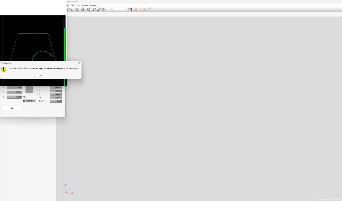

[Mi...] Posted March 18 Share Posted March 18 Hi, I try to qualify the LineScan One, on a Spectrum machine with rds CR5, and after i press qualify stylus i got the message "the current probe cannot qualified. Please first determine the length of the reference stylus". somebody knows how can i solve it? Link to comment Share on other sites More sharing options...

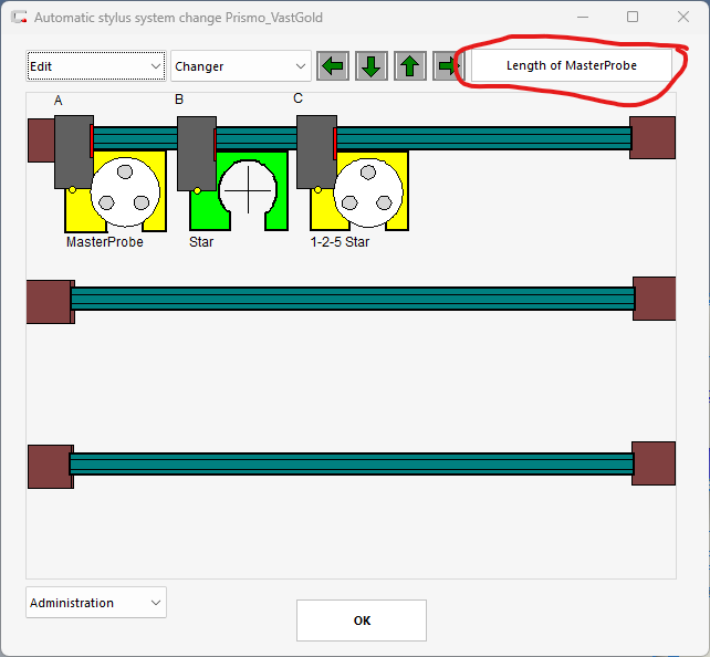

[Ri...] Posted March 18 Share Posted March 18 I'm not familiar with that LineScan, but it seems to need the length of the MasterProbe, so open up the Automatic Stylus System Change, there should be a button in the top right to measure the Length of MasterProbe. Link to comment Share on other sites More sharing options...
