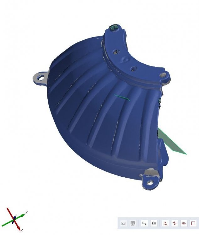

[Pi...] Posted February 13, 2023 Share Posted February 13, 2023 Hello, how can I do a section on a plane made by myself not the referential plan. Link to comment https://qualityforum.zeiss.com/topic/2626-section-in-relation-to-a-plane/ Share on other sites More sharing options...
[Na...] Posted February 13, 2023 Share Posted February 13, 2023 Hello Pierre, you can chose this plane in the dialog as the reference plane. Nanno Link to comment https://qualityforum.zeiss.com/topic/2626-section-in-relation-to-a-plane/#findComment-6856 Share on other sites More sharing options...
[Pi...] Posted February 13, 2023 Author Share Posted February 13, 2023 Hello Nanno, I tried to select it in the left menu and also by clicking on the plan, but it always keeps the same cut . Is there a tuto for this? Link to comment https://qualityforum.zeiss.com/topic/2626-section-in-relation-to-a-plane/#findComment-6860 Share on other sites More sharing options...
[Na...] Posted February 13, 2023 Share Posted February 13, 2023 Hello Pierre, there is an example in this introduction course (part simple inspection): https://training.gom.com/home/LearningPath/7265 Regards, Nanno Link to comment https://qualityforum.zeiss.com/topic/2626-section-in-relation-to-a-plane/#findComment-6864 Share on other sites More sharing options...
[Be...] Posted February 13, 2023 Share Posted February 13, 2023 Hi, one further hint: To create an inspection section you have to use a nominal plane. A nominal plane is created on your CAD data. If your plane is created on actual data and you need a nominal data you can call 'Operations -> Elements -> Convert to nominal data'. But keep in mind: The parametric for your nominal element will lose their creation history. Therefore I recommend to construct your nominal plane directly on the nominal dataset. Hope this helps?! Regards, Bernd Link to comment https://qualityforum.zeiss.com/topic/2626-section-in-relation-to-a-plane/#findComment-6866 Share on other sites More sharing options...
