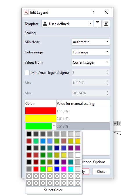

[Sa...] Posted February 13, 2023 Share Posted February 13, 2023 Hello, Are there any options in ARAMIS or Correlate for changing the color bar beyond the built in GOM continous/8 colors/3 colors options? If anyone has any experience to share related to customizing the color bar potentially to create something like the ones listed here (https://colorcet.com/) that would be great to know. Thanks, Link to comment https://qualityforum.zeiss.com/topic/2630-options-for-changing-the-color-map/ Share on other sites More sharing options...
[Ma...] Posted February 15, 2023 Share Posted February 15, 2023 Hi. Yes you can change it "fine tune it " for your needs 🙂 Press RMB on the Legend and chose Edit Legend. You will see lock signs (built in legend display settings) You need to create an user one: Than lock sign will change to user head. And than you may create your own settings MK Link to comment https://qualityforum.zeiss.com/topic/2630-options-for-changing-the-color-map/#findComment-6878 Share on other sites More sharing options...
