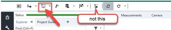

[Ra...] Posted February 16, 2023 Share Posted February 16, 2023 HI, I work in GOM Inspect Pro 2022 and I have a few questions. - writes the program using Smart Teach and after scanning I perform recalculation and polygonization. When the polygonization ends, Atos automatically adds the next scan items in the program. Why is this happening and how do I turn off the automatic addition of another scan? Link to comment Share on other sites More sharing options...

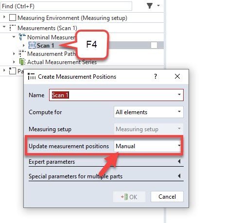

[Ma...] Posted February 23, 2023 Share Posted February 23, 2023 Hello, this should not happen. There seems to be something wrong in your project. Please get in contact with your local contact and send the project for analysis if that's possible. Thank you! Only to be sure: You used the left toolbar button for Smart Teach, you didn't use the right one which is called "Smart Scanning", did you (see screenshot)? As a workaround you can switch the nominal measurement position series to "Manual", see screenshot. Afterwards, no measurements will be added automatically any more. Regards Matthias Aalto Link to comment Share on other sites More sharing options...
[Ra...] Posted February 28, 2023 Author Share Posted February 28, 2023 Hi, Thanks for the info. Yes, I used the button on the left. In the F4 window I had the automatic set, now I changed to manual and it's OK. Link to comment Share on other sites More sharing options...
