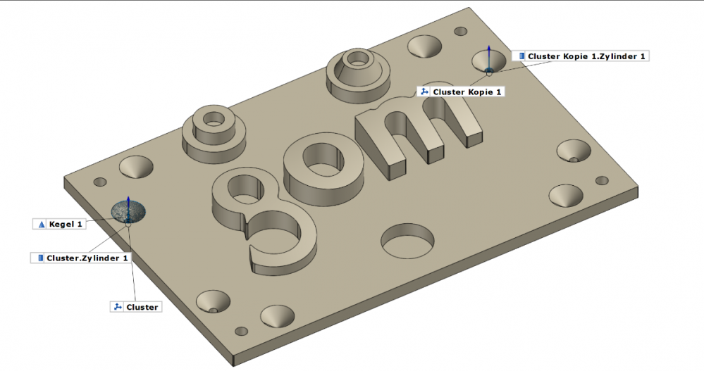

Is it possible to edit a cluster after creation and copying?
If for example I created an nominal element (Zylinder 1) and created a cluster (named Cluster) with this element and copied it like in the following picture. Now I also want to Inspect an other element with allmost the same positions (Kegel 1). Is it possible to add this to the existing cluster and it's copies? Following the parametric logic, it should be possible, but I can't find out how.
This example is quite simple, but with big arrays of clusters it's quite tedious to create all these cluster-copies again.
Best Regards,
Simeon Frei
Sorry this is not possible in the moment. But we have a created a software wish to include this feature in a future version of the GOM software.
