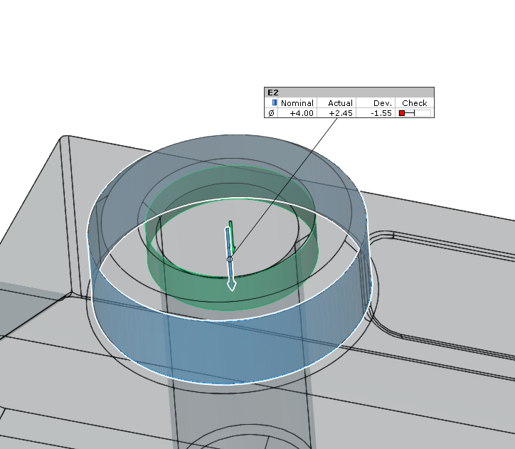

[Yi...] Posted March 16 Share Posted March 16 Hi Regarding this question, I face the same problem when trying to asses diameters of touch probe cylinders. The final result is the nominal value after reducing the 1.5mm probe diameter. The actual cylinder is already created with this offset and I am trying to figure out how to solve this compensation problem. In the same way, all the actual plane are getting an offset location of 1.5mm I use the assignment of the measuring principle of a touch probe and then a guided touch probe and this reduction of the probe diameter is consistent. I would be happy to receive an explanation of how to solve this Many thanks Link to comment https://qualityforum.zeiss.com/topic/2747-touch-probe-question/#findComment-147775 Share on other sites More sharing options...
[Yi...] Posted March 17 Share Posted March 17 Please sign in to view this quote. Hi The root cause for the above mentioned offset already found. Thanks anyway 1 Link to comment https://qualityforum.zeiss.com/topic/2747-touch-probe-question/#findComment-147837 Share on other sites More sharing options...
