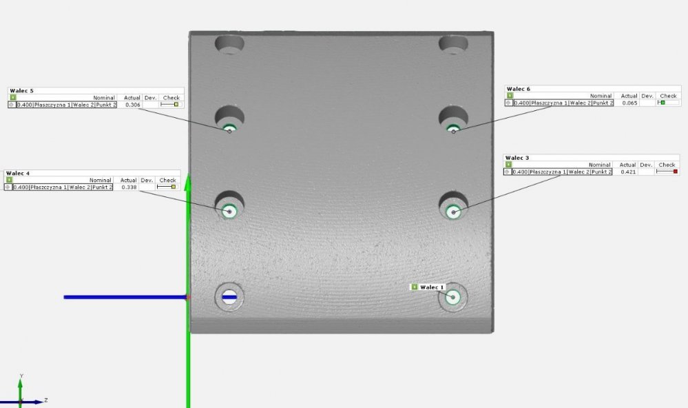

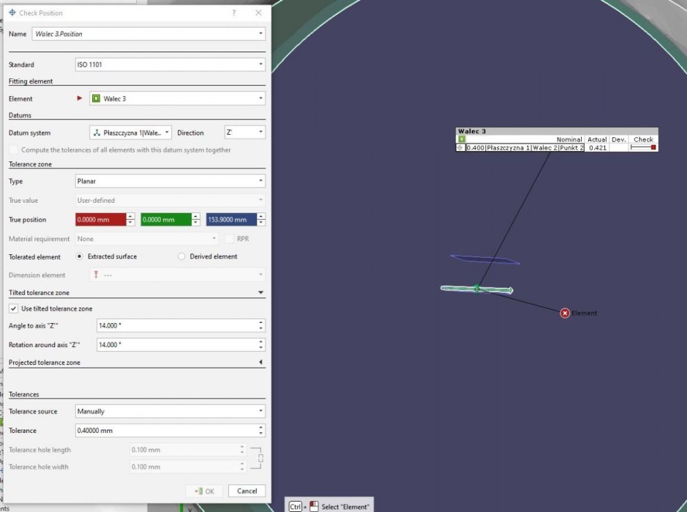

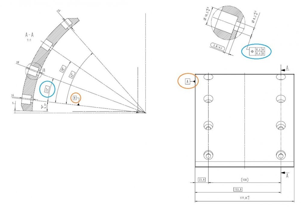

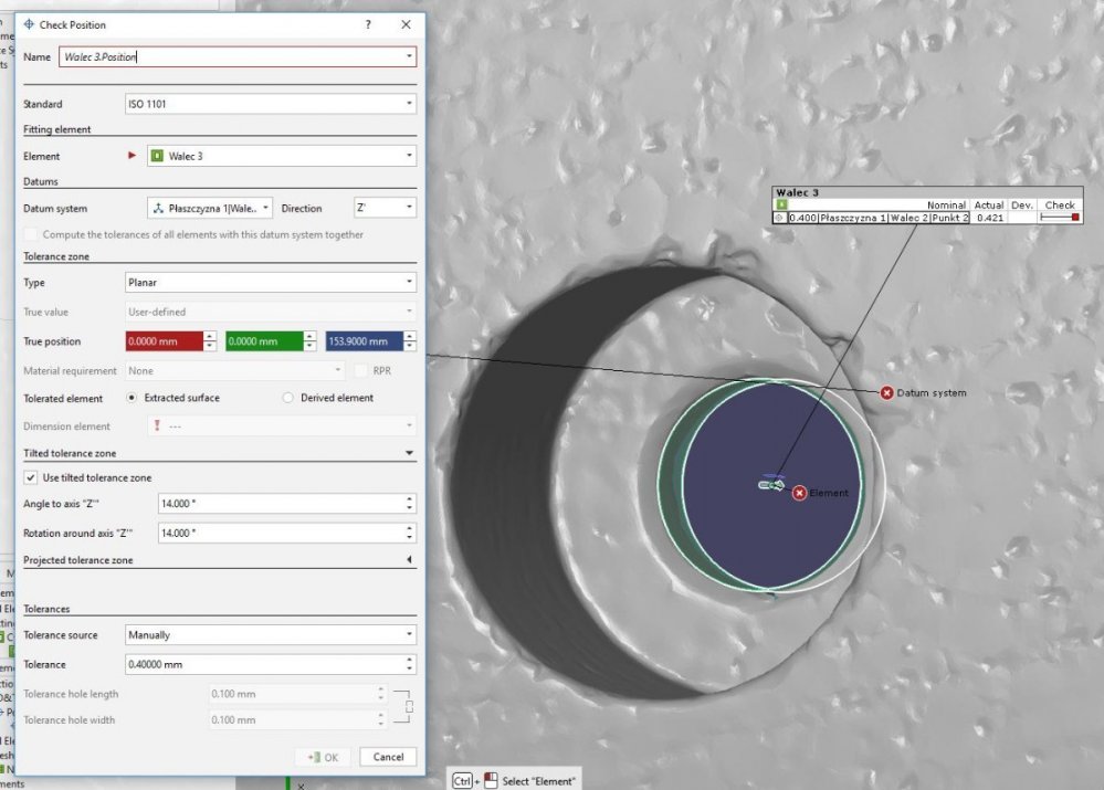

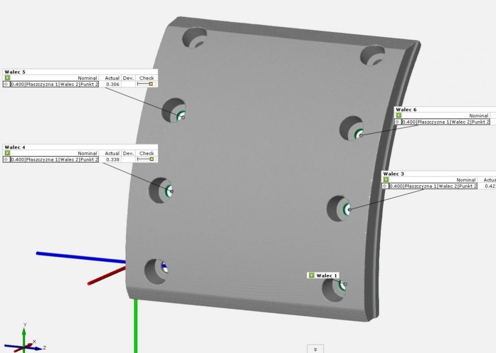

Hello,
I want to measure the position of the hole relative to two bases. The problem is, that I'm not sure if I have the right settings. Consequently, I should get a square tolerance field tilted at 14°. However, I see that the inclined tolerance strip is established at first (and don't see the tolerance from the base A). Could you please tell me if I'm doing it right? rys.thumb.jpg.6641547a4af82e7c16681794c3819398.jpg
