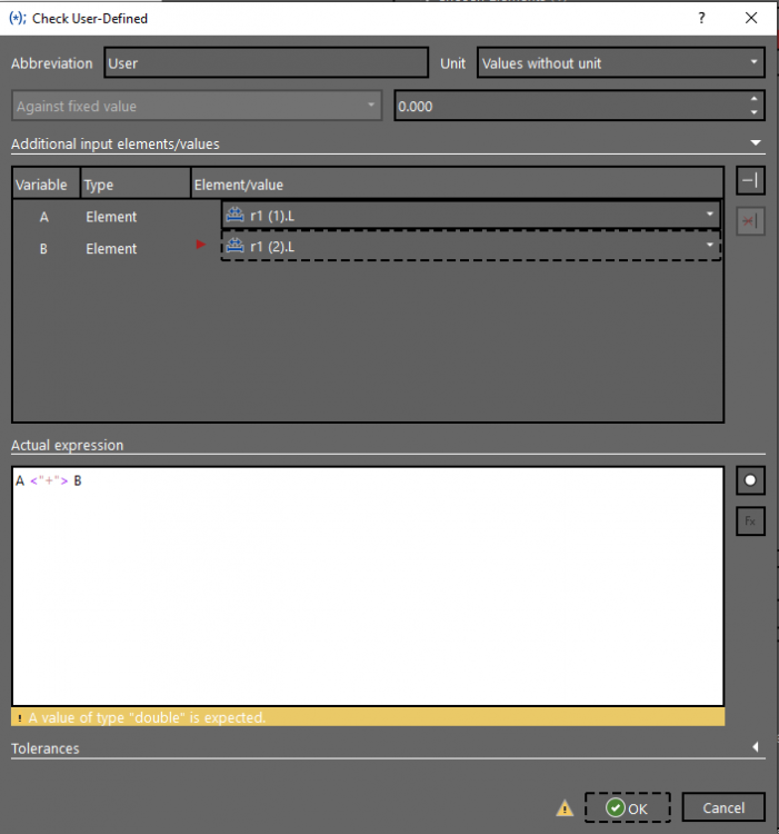

[An...] Posted March 20, 2023 Share Posted March 20, 2023 Can somebody explain / show examples how can i do simple operations like adding in here ? Here i just need to add couple of 2pt distances and report them as one so nobody needs to use calculator Link to comment https://qualityforum.zeiss.com/topic/2767-how-to-do-check-user-defined/ Share on other sites More sharing options...

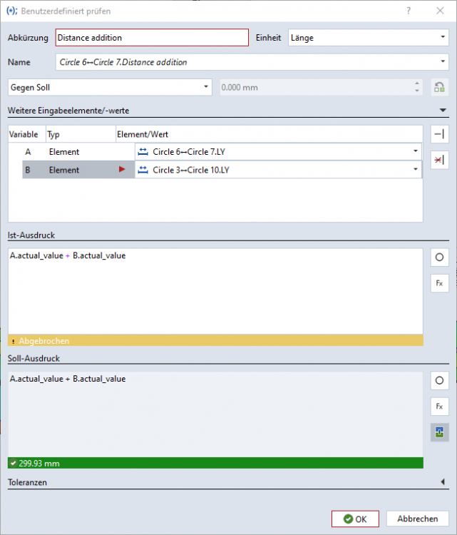

[Na...] Posted March 20, 2023 Share Posted March 20, 2023 Hello Andrzej, you have to access the values with a dot after A and B. Regards, Nanno Link to comment https://qualityforum.zeiss.com/topic/2767-how-to-do-check-user-defined/#findComment-7259 Share on other sites More sharing options...
