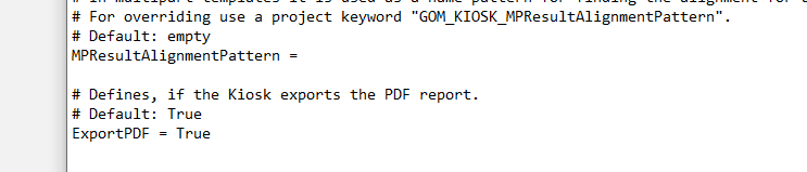

i was wondering if it is possible to define what will be exported after making the decision of OK/NOK part after finishing KIOSK template?
Basic setting exports PDF and ATOS file with both scan and measurement series data.
below listed is a screenshot from KioskInterface_settings.
will ExportTABLE_OF_CONTENT = True work?
Is there a way to include full export of Table of content = .CSV ? And is there a way to erase the measurement series itself and keep the ACTUAL scan data only?

Adding a picture/screenshot
Or is there a way how to call a script during KIOSK operation before finishing the KIOSK template run?

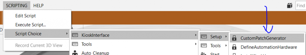

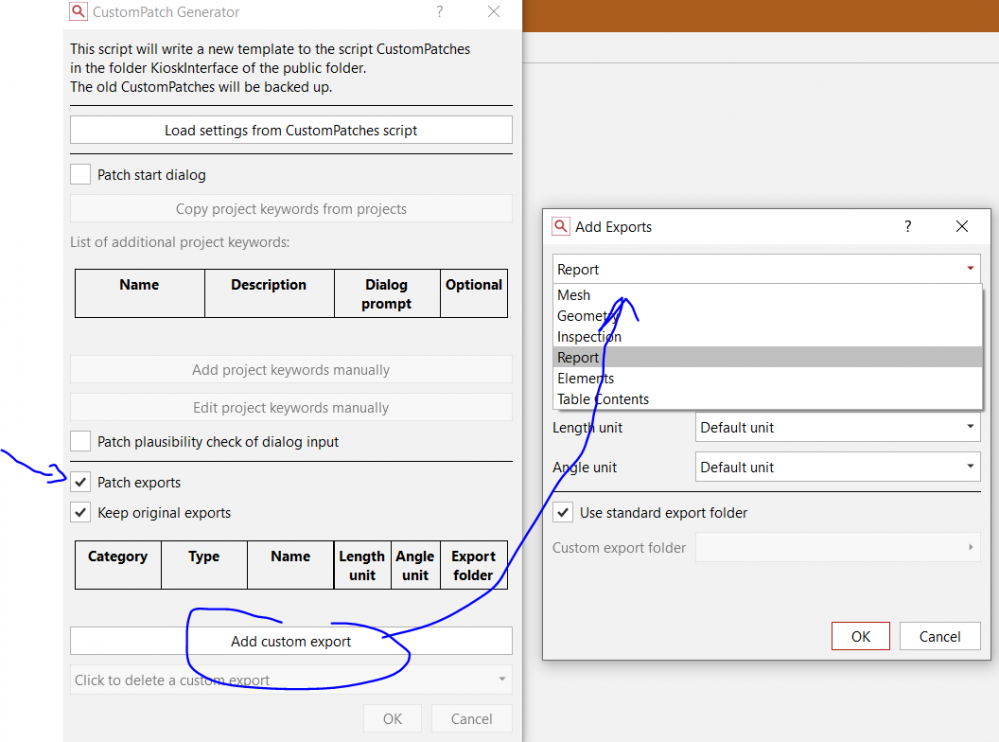

Hi,
 exporting CSV and G3D format at the end of the KIOSK operation can be done by running CustomPatchGenerator
where you can select what will be exported
when you are done with adding, just click OK and this will save the setting for all KIOSK projects.
Its important to mention this tool does help , but only to a point.  If you want a special name for the export or a special directory then you need to code this yourself.

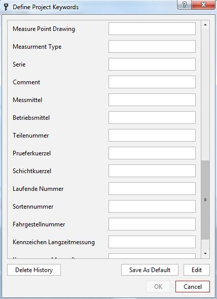

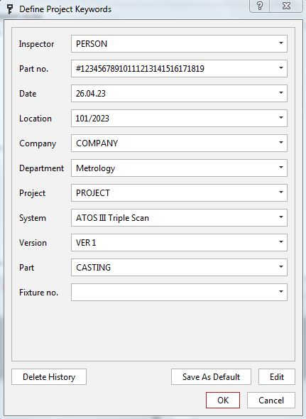

Now i have problem with project keywords...
My standard project keywords window looks like this:
But no headers are generated for the measurement file.
After the export, new, additional, unknown keywords appear in German language:
Question:
How to set it so that the informations that I am currently using appears in the header of the measurement file?
